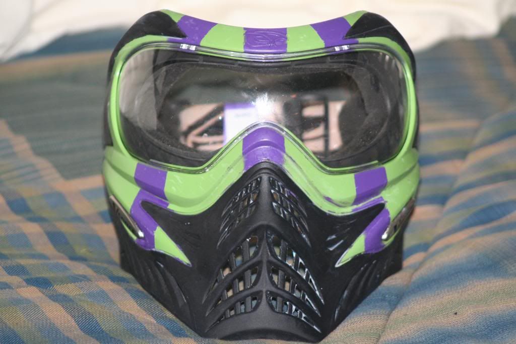

Here are mine, tried to do some two tone coloring for fun
might strip it and do a half and half so it doesn't chip like it did on the left side

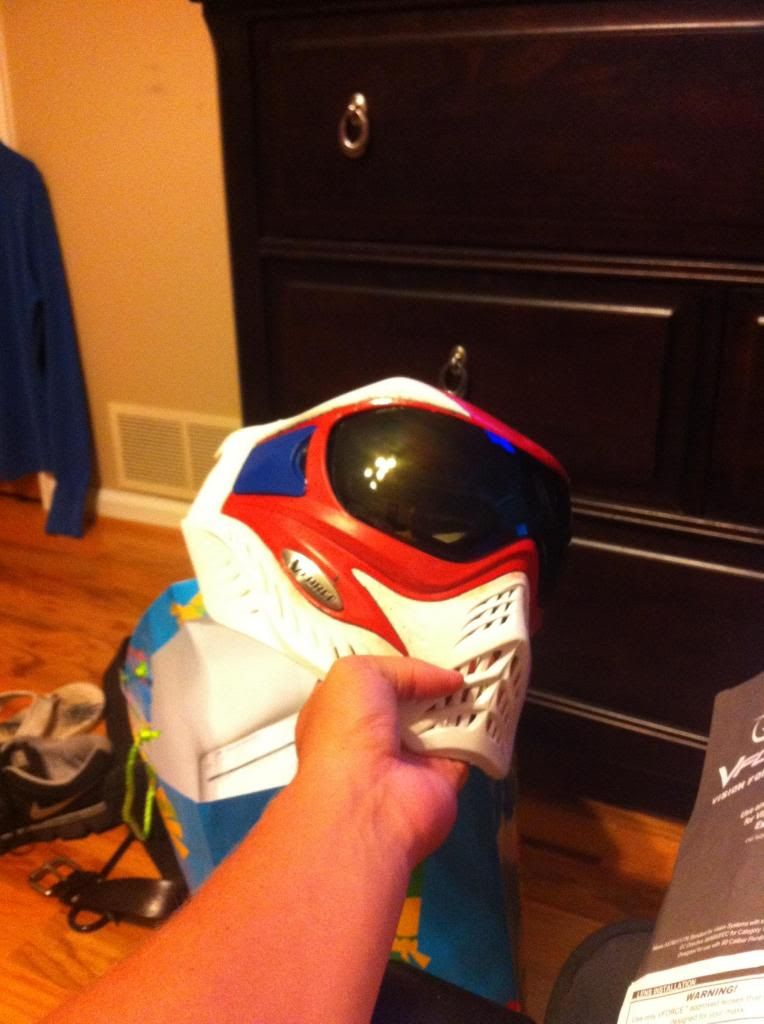

I bought the mask for $10 it was in bad shape. I ended up buying another lens on my local FB group for $10. I had some black/white plastidip laying around and here is my progress of what I did throughout this project.
I ended up masking the rubber to paint the plastic.
Black Plastidip
The rubber portion really bothered me so I decided to paint that too.
I didnt mask it right and messed up from the pictures above and decided to do it all over.
Went to play paintball a few days later and got a scent of banana scented paint and it started to crack. So I yet again started pealing it off. I retrofitted a KM strap ($25) I bought from the field because i've been dying to get this for years.
I'm trying to go with a theme on this with my favorite brand 9Five with Teal/White/Black so I'm back on the drawing board scheming on how to do this.Not bad for spending around $45. I will post progress.Thanks for looking.

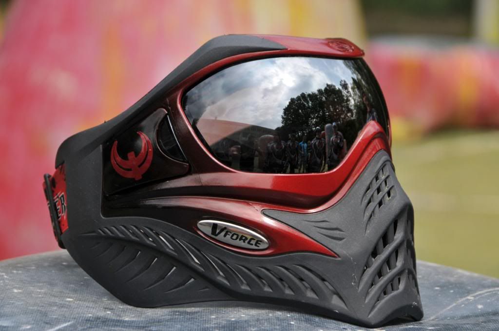

Alright, since I gave up on the Stormtrooper, I've learned a few things!
Eventually your white Grills will start to stain - this is largely why I gave up on my Stormtrooper idea. If you can live with the stains, power to you, I'm a little too much of a perfectionist especially when it comes to Star Wars!
To dye your V Force Gill is an inexact science at best - Green dye came out blue. A yellow dye bath for your now-blue mask came out greyish green. Another yellow dye bath turned that darker gray. A boiling water bath can pull a lot of that pigment out. Suddenly, green dye turns a light gray mask green. Many more dye baths later, a black dye bath for a dead greenish-gray turns it a lighter dead, purple-gray. Another black dye bath doesn't affect the color at all. Three weeks in a black dye bath makes it a slightly darker purple. White Krylon Fusion barely changes at all, and white Plastidip dyes very inconsistently. Eventually, you'll get fed up with dye.
I cannot overstate how important it is to use your exacto knife well - clean cuts on your taping and cleaning up your edges afterward is a HUGE margin between a hack job and quality, professional-looking work.
It might not hurt to sand the plastic first - it may not help either. Ultimately, all the time and effort you put into this mask will make you want to make sure it's perfect, and if sanding it will give you a sense of security, then save yourself the anxiety up front. If you're sanding off an old paint job, the sanded-off paint dust will stick in the rubber if you rub that sandpaper on it at all. Frankly, I haven't found a way to prevent this, but I imagine you could probably tape it off. I've been putting the mask in boiling water to pull it back out, which gets most of it. I imagine a little soap-and-water scrubbing could probably work as well.
Sanding off your old paint job is slow! - I tried paint stripper again, and three fifteen-minute coats later, the plastic and rubber don't show any visible signs of being chemically eaten or melted. That's MY experience though, and after all the things I've put my mask through, I my have created a super-mask a la countless comic book characters.
Don't be afraid to try stuff - it's a pretty easy process once you're comfortable with it, and so far I have yet to do anything to actually ruin the mask. If you REALLY feel like you've done irreversible damage, the cost of these masks is a drop in the bucket for paintball players. If you're bored or creative enough to feel compelled to do this sort of thing, it's obviously worth your money to find out what you can do.
Different spray distances produce different results - up close (3-6") will give a very thick, very smooth, high-gloss finish that cracks pretty quickly. The recommended (12-14") distance produces a much thinner, slightly rougher, slightly-lower-gloss finish that I'm fairly certain may never crack. You'll need 3-4 coats either way, because you WILL find spots that you missed or that didn't cover right. Obviously, most people will go for the "Crackless Method," but in my case with the Stormtrooper, where I was going for a specific look, the ultra-high-gloss finish worked in my favor, not to mention the constant wind whenever I had time to work on it didn't particularly agree with a longer spray distance.
Plastidip can work - as long as you want Black, white, red, or yellow color schemes, because as I said earlier, it's very splotchy when you dye it. Also, while the main part of the coat doesn't peel all that easily, your edges will be very susceptible to rubbing right off. If you try a plastidip scheme and don't like it, it will peel off with some effort and patience.

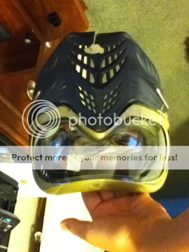

Hey guys and girls I decided to trie it on my grillz.Turned out alright with gold.Just need to work on edges.
