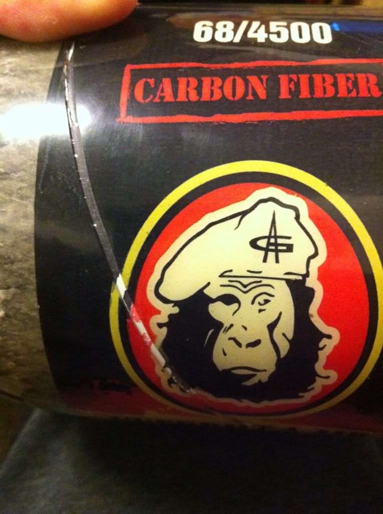

Here's a pic of it
Lil bit longer than I remembered but still any opinions on if this is safe to use still? 5months left on hydro too

rcontrera
rcontrera's Avatar
Just turn it in for hydro early and have it repaired at that time.

Each manufacturer has a different way of handling cracked tank warranty issues. You will want to call the manufacturer of the bottle you have a crack in to see if there is any cost associated with getting it fixed.
If yours is a Ninja, we have a program in place where you can send it in for free to get a new gel coating applied and the bottle manufacturer will also pay for the return shipping to get it back to you. It takes 3-5 business days from the date they receive your bottle to get the work completed and ship the bottle back to you
