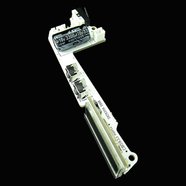

Originally Posted by FreeStyler15 View Post
i asked on virtue to what board can fit the FX and they sent me a board same for the f7/f8, at least they said it fit mi fx too, so i think i will have to wait til arrives to me and if doesnt fit i think i will try to do something to make it fit
I'm pretty confident it isn't going to work.
The FX board again - note that the buttons are near the middle of the board:
The Fusion/F8 Virtue board - note the buttons are toward the bottom of the board. Also, the holes to screw down the board are not in the same place as on the FX board.

FXpaintball3r
ok so I also came across a similar issue with my board but after putting the thing under the microscope i notice that the wires coming from the battery adapter that is connect to the male insert that goes into the board itself was somehow broken off. Guess this was due to the wire being at a 90 degree angle from the male inserts. I'd tried to solder the male end back onto the wires and it did end up being just a broken wire issues. Afterward I just order a replacement battery connector from DP and works just as good as new since I can't seem to find a 9V battery adapter that has the correct male port to go into the board at radio shack.
NOTE**(This was my board symptom: just turn on for a quick second and died off like that thing shorted out or looks like the battery was bad / low. Never did see dots and or lines)
FXpaintball3r is offline   Reply With Quote
Old 02-01-2013, 02:16 AM #31
CA_Tectonics
CA_Tectonics's Avatar
Location: Northern CA
- Good to hear you figured it out and it turned out to be a relatively easy fix. Those molex connectors are difficult to track down, especially trying to get the correct one. Not something most places carry as stock on hand.

FreeStyler15
FreeStyler15's Avatar
Location: Cuenca- Ecuador
yeah, that is right, but in this case i just noticed the male conectors in the orange ribon that goes from the screen to the board is a little dirty or something, cant figure out what exactly is that but i think its mud, i cleaned it, put it back plugged and then: nothing happened, so the board didnt turn on anymore, i talked to DP and told me, they dont sell just the screen so i think i have to buy a bnib fx board or look for something better at a good price
