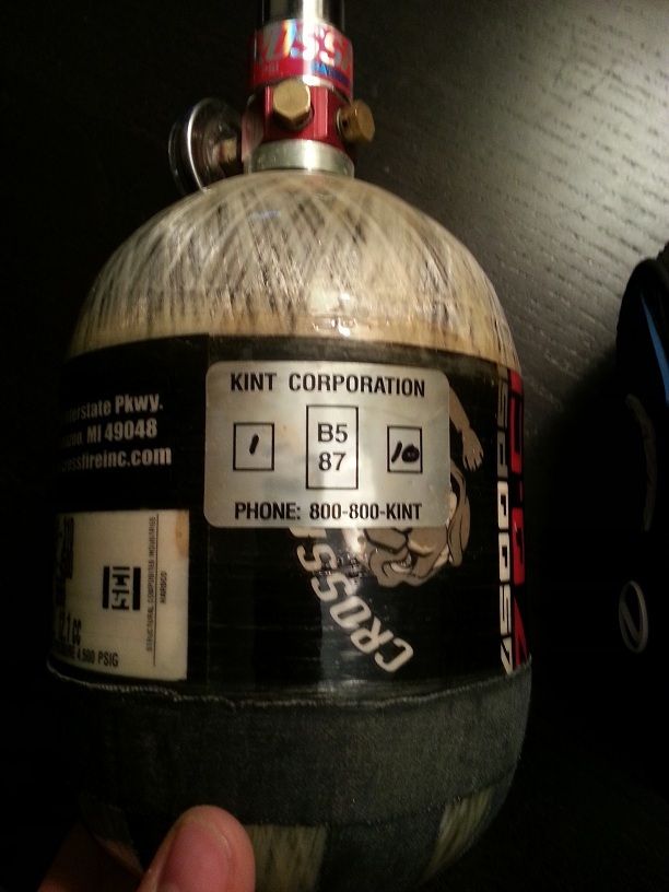

Still a little confused about the 3/5 year difference. Can someone help me out with this one. I know it was born on 05/04 and re-hydro'd on 01/10.
