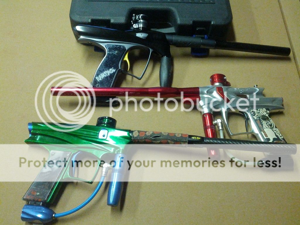

Old 01-08-2013, 02:37 PM #670
p8ntballr68059
Post whore since 08
p8ntballr68059's Avatar
Location: corn&cowville
p8ntballr68059 is Boss
family portrait
GSA FOREVER
