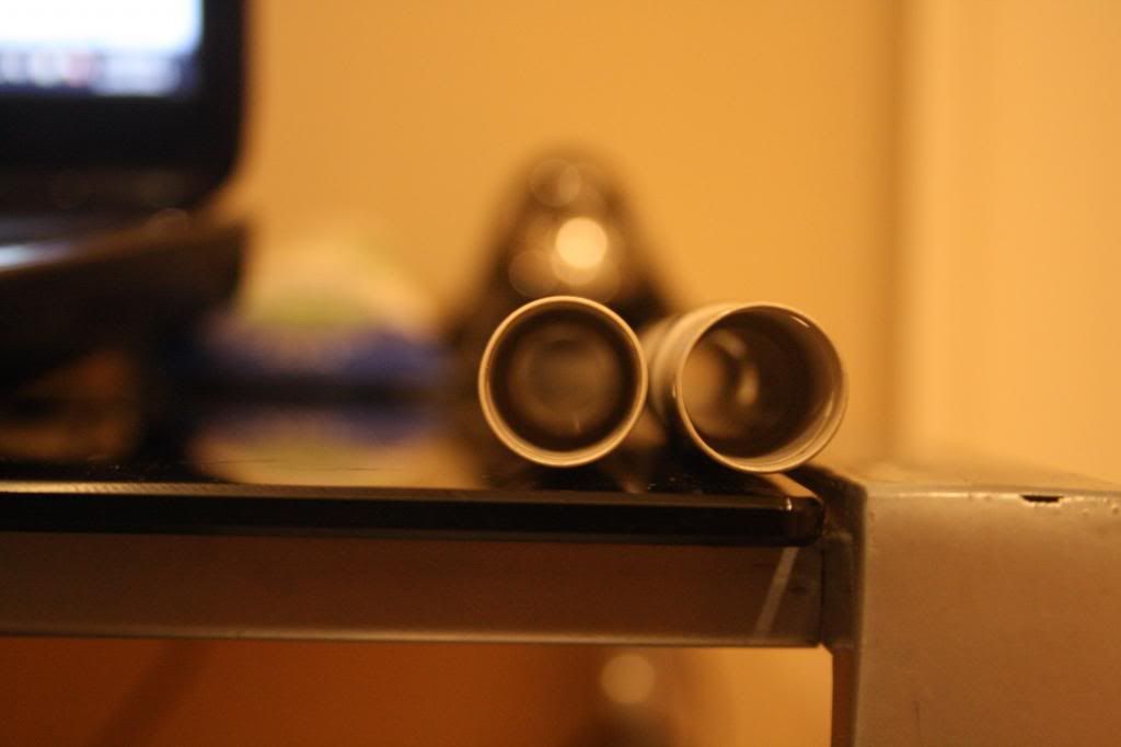

Hey guys, I got two of the latest and greatest eigenbolts and neither seems to want to cycle. Shocker runs fine with the HE bolt, swap out to either eigen and it's almost like I'm getting pneumatic lockout - the bolt will not budge but the noid is definitely puffing away with trigger pulls. I pulled the entire engine and the eigens seem to slide smoothly (even one has an out of round back, seems the package got shmushed in the mail) so I've swapped back and forth between the HE and both eigens a few time with identical results. I've tried searching around for similar issues with the latest batch to no avail - did I miss a memo about needing to run new oring sizes somewhere in the engine or do I just have crud luck?
*EDIT* Picture of out of round back

1) do any of the orings particularly the bolt guide tip feel like a tight fit?
2) when its all assembled pushed the bolt back and forth. Does it still feel like its moving smooth and free? If not try backing the guide out a 1/16 - 1/4 of a turn and check it again.
3)pics of the out of roundness?

1) No it feels smooth
2) Fully assembled it was a little tighter than the HE bolt I had in there but nothing significant
3) Will get that up tomorrow

Tzz is it the one on the right thats out of round?
