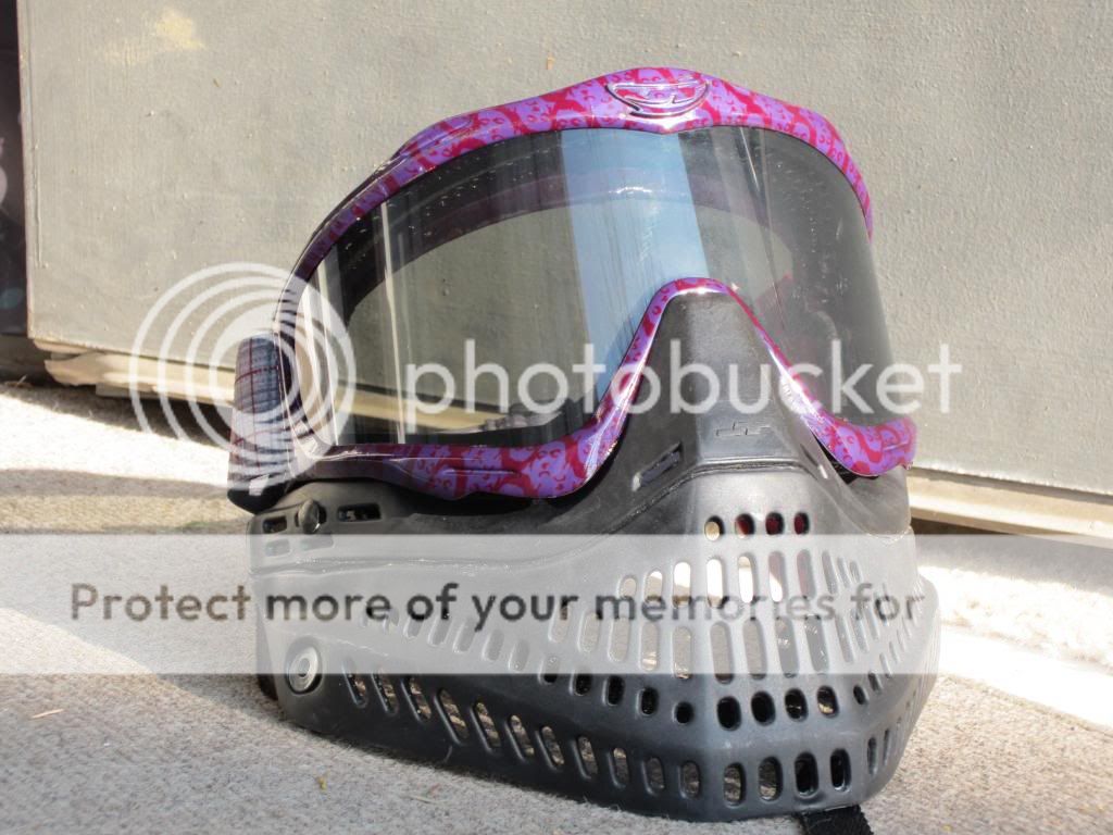

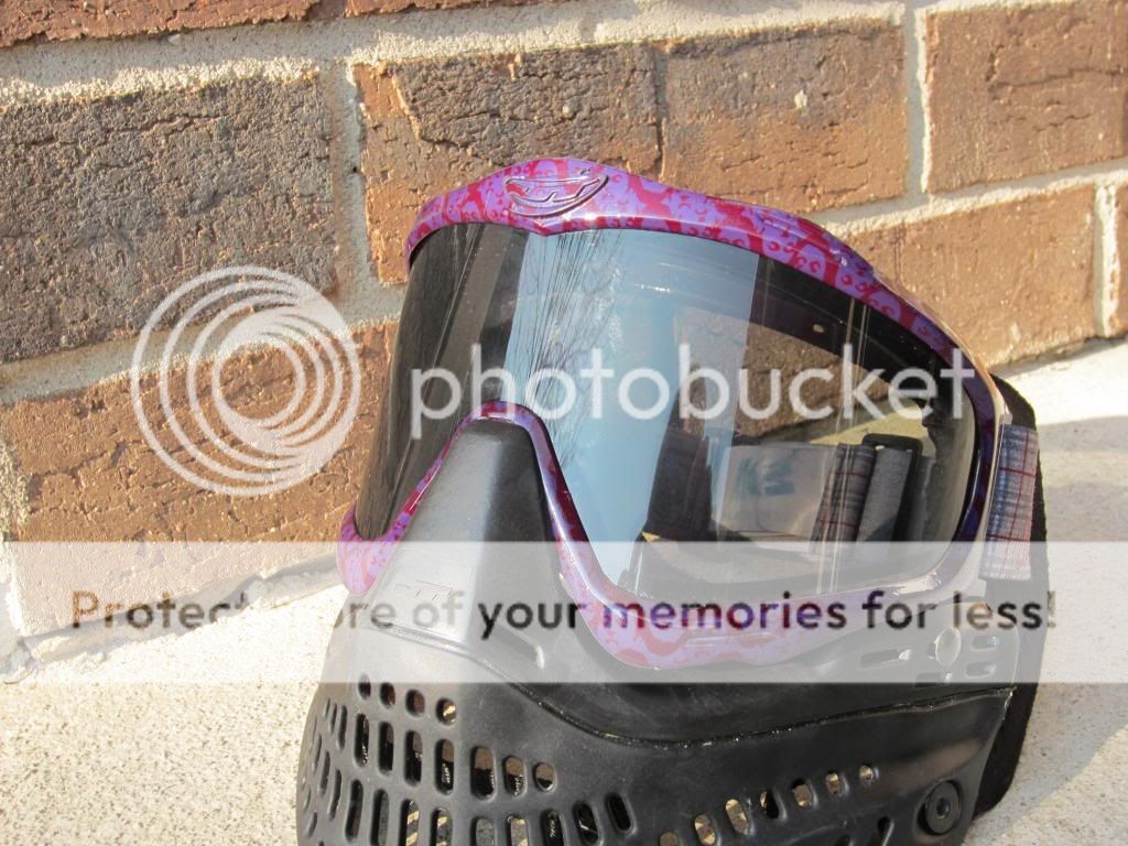

Old 11-16-2012, 11:59 AM #897
sameagol26
Youtube = BTDeltafan101
sameagol26's Avatar
Location: Ontario, Canada
sameagol26 is playing at Living Legends V
sameagol26 is playing at Living Legends VI
sameagol26 is for the Gunfight
sameagol26 has achieved Level 4 in PbNation Pursuit
Originally Posted by sameagol26 View Post
Alrighty, I'll try my luck this weekend
Ok, lads I've finished the dying process and now I am just waiting for the pieces to dry. I'll leave you in suspense until I get the mask together
Marker Sale!!! http://www.pbnation.com/showthread.php?t=3938644
Proud owner of a Demon, Creed, GT and 1 of 30 'Murica Geo+
#26 Storm Runners and Citrus Connection Paintball
Youtube- BTDeltafan101-http://www.youtube.com/user/BTdeltafan101?feature=mhee
sameagol26 is offline   Reply With Quote
Old 11-16-2012, 01:14 PM #898
sameagol26
sameagol26's Avatar
Alright guys, what do you think????
BEFORE:
[IMG][/IMG]
AFTER:
[IMG][/IMG]
[IMG][/IMG]
I'm calling it the "Grape of Wrath"
Old 11-16-2012, 02:10 PM #899
D-man[WarLlamas]
Old and in the way
D-man[WarLlamas]'s Avatar
Location: Tulsa, OK
D-man[WarLlamas] posts videos on PbNation
D-man[WarLlamas] has achieved Level 1 in PbNation Pursuit
D-man[WarLlamas] has achieved Level 2 in PbNation Pursuit
D-man[WarLlamas] has achieved Level 3 in PbNation Pursuit
Some helpful info you could include. What color dye did you use? Liquid or powder? How long did it stay in? What temp of the dye? etc.
But it looks nice.
D-man[WarLlamas] is online now   Reply With Quote
Old 11-16-2012, 02:36 PM #900
sameagol26
sameagol26's Avatar
But it looks nice.
Thanks! Ok, well I'll do my best to sum up the "grunt work" (forgive me this was a first time attempt at dying a mask). So here we go:
step 1:
I pulled my mask frames from the bottoms, and removed my lens and strap. I very carefully pulled off the foam with a "pinching motion."
Step 2:
I purchased RIT powder dye (denim blue) from my local Michaels Craft store for $3.99, and cheap nail-polish remover from the drugstore for $1.99.
step 3:
I boiled 2 large pots of water on the stove until it was nice and steamy (estimated amount of water would be around 2-3 gallons)
step 4:
While the water was doing its thing, I poured out the entire container of my el cheapo nail polish remover (35mL worth) and rubbed the mask (while wearing gloves) with a hard-bristled toothbrush for approximately 10 minutes (not sure if this step actually did much)
step 5:
The water came to a boil, so I poured it into a 5 gallon plastic container (previously used to store junk in). I then poured the rit mix (just one box) into the boiling water and stirred it for 5 minutes.
step 6:
I placed the goggle frames into the mix and every 5 minutes I would use a plastic pair of tongs to examine the frame's progress. After 20 minutes, I was satisfied with how the frames looked, and pulled them out (while wearing yellow cleaning gloves).
step 7:
I placed the goggles on an old towel and sprayed them off with the hose (with luke warm water). Then I towel dried them and re-assembled them!

Old 11-16-2012, 02:41 PM #901
sameagol26
sameagol26's Avatar
also, the frames look much darker (a cross b/n a navy and a deep purple), but when in sunlight they reflect the sunlight quite nicely! This was totally a pleasant surprise. I felt like I should mention this because, although I did use a blue dye colour, the colour came out more "purpley." So, I guess it's just a word of warning that sometimes the dye you use may produce unpredictable results. All part of the experience, I guess!
