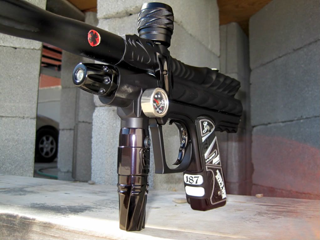

I did this purge hole on my drill press

I did the LPR purge hole with a 1/16 bit and a drill... I can say that this is a MUCH needed mod. My pressure was dropping pretty bad in PSP, but since the mod the LP drops may 10 psi.Great job on this one juit.
I also did the macroline (tape) mod, but need to get to a chrono to test.
One thing that I did since the stock bolt had some pretty bad wear on the tip is polish the very front. I also added an oring on there as a front bumper. Overall I am VERY pleased with the results.
