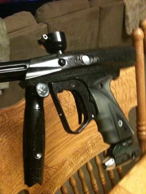

question... Did you also powder coat the inside of the body where the engine slides in?
NO. Any Holes were corked to keep any powder from entering any vital areas. The Mil Thickness of powder coating is much thicker than hydro dipping or annodizing. careful attention is made to keep the powder away from any moving components.
I'd imagine getting any inside would essentially destroy the body?

Powder is just ground up plastic. Some of the specialty powders do have some metals in them like the stardust. If some gets into an area it can be removed with chemicals. Like the barrels all the small holes at the end I install cork all the way down and on the ends to keep the bore clean. Fiberglass or aluminum tapes work good but they leave some residue.

another question, by the looks of it, how much MIL thickness do you think the powder coating added to your body?
Average for a hot applied. .0015" (Part heated then coated) This is how I done the SFT.
Cold applied .002-.003. Powder Applied then put in oven.

Huh, hot isn't much thicker than Type III.
Sounds like you knew what you were doing, and it looks great! Nice work.

Thanks. Been doing powder coating for over 10 years. Mostly Motorcycle and Automotive stuff. Son plays competitively I just tinker with guns. Lol
