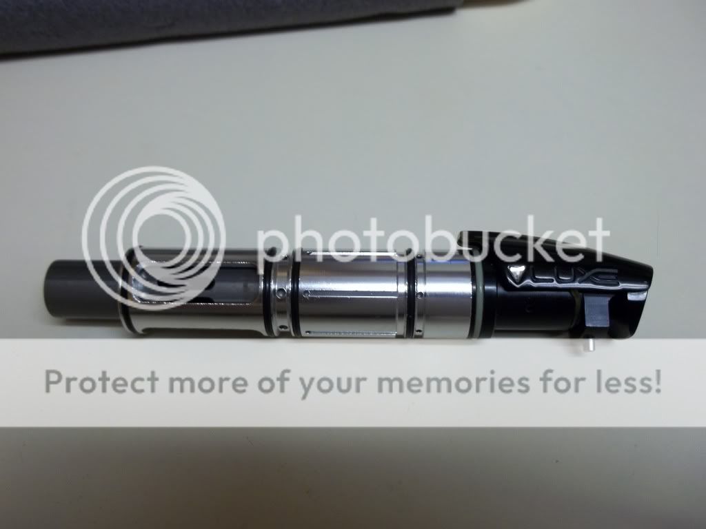

1.5 has screws in the eye covers
2.0 has latches on the eye covers , also new 2.0 board and 2.0 powercores
this is a 1.5 pictured below
