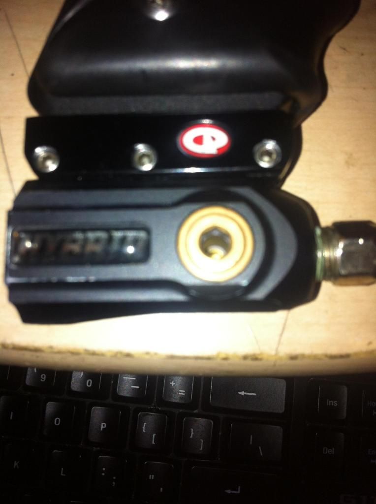

I have a Smart parts ion with a Hybrid on and off push button Asa. I need help to figure out why its leaking air and how i can fix it. It only leaks air when I open the asa. It a little leak coming from the hole in the button. I will post a picture. And if i need to place o orings what size are they and where can i get them.

Unscrew the button and check the orings. They may need to be replaced or at least relubed. You'll need 2 allens to remove the button.

No. It doesn't just sit and vent out the tank pressure when you turn it off. It should hold pressure when it is on. If it isn't, you probably have bad orings. I just finished replacing the o's in one of the ones I have. There are 3 10/90 orings in it. You'll need 2 3/16" allens. when putting the screw side of the button on DO NOT OVER TIGHTEN IT!

those hybrid push buttons were known for being hard on o-rings, so its most likely the cause. pro-rookies vid should show you just what you need to do to fix it.

Thank u for ur help but i opened it up relubed the bolt but i cant see any o rings in there. I need ur video cause i have no idea how to fix it. And its holding air when i close it kinda. but once i open it ther e is air coming out the buttons for each side.

I cant find the O rings in there. When i took out the button which i called the bolt. the space is hollow and just holes in it. I put greased on the button and slid it through the asa and screwed in the other button on the other side. I tested it out and air still comes out the side when i open it. and its starting to come out when its closed. I need that video so i can fix it.

I wasnt rushing u or anything. I was just telling them what was going on. Thank you so much for the video. I did as u did and lubed the o rings and the inside. I put it back together only to find out it lets all the air out when i close it. I will get new o rings tomorrow and report back. Thank you for making the video.
