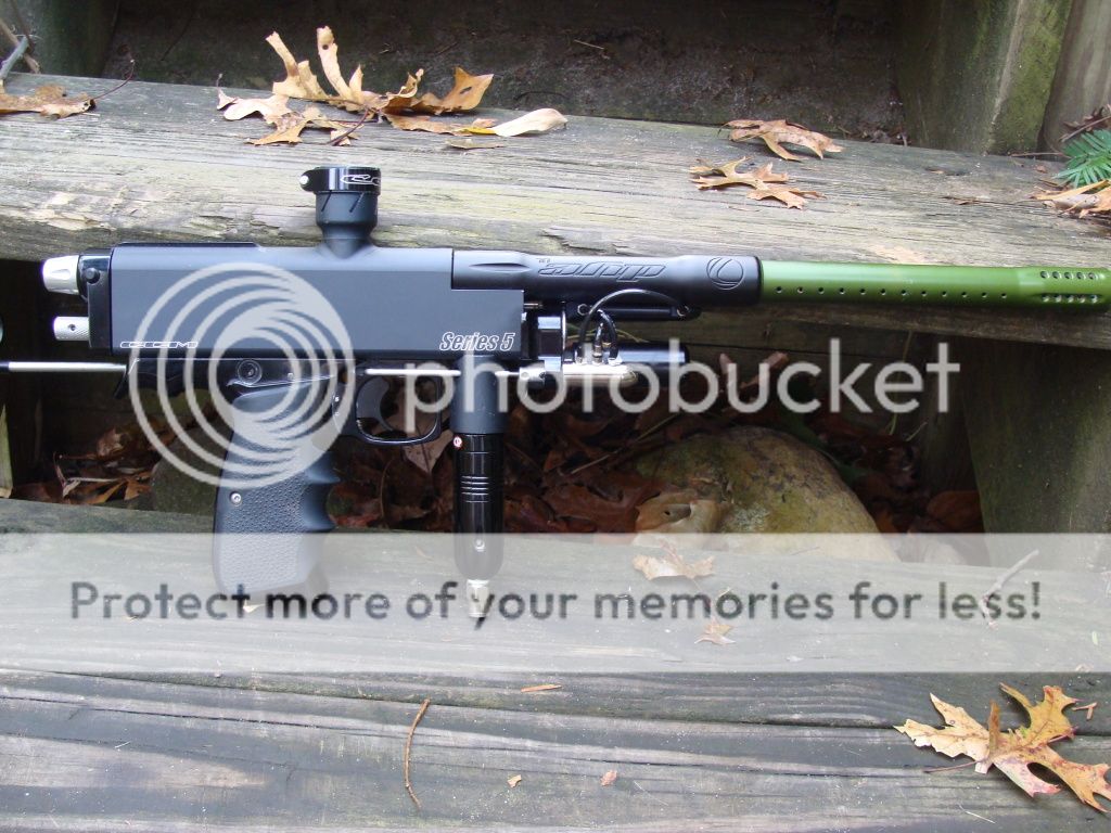

Hey whats up guys. Ive been out of the semi-cocker game for awhile and i recently traded my pump gun to one of my really close friends for this beasty right here. I used this gun about a year ago and i LOVED IT and had to have it. A few questions i have concerning this marker.
1. What is the current rarity of the CCM slider frames? I know at one point they were in high demand but i know paintball is constantly evolving in terms of whats hot and whats not.
2. Right now im rocking a stock 3-way from an 04 pro stock. Any suggestions on an upgraded replacement. Im thinking about a shocktech but im always open to professional advice.
3. If anybody can throw out a value on this set-up that would be awesome.
Thank you guys so much for sharing your knowledge with me

1) The CCM 86 slider is quite rare. People will pay $100 for just the frame.
2) If you like the trigger pull, no need to change. If you want to upgrade, get either a black ST bomb or Belsales hollowpoint to shorten the trigger pull.
3) Value is about $320-$350 as it stands.
Its a solid marker, but its missing a lot of original part, and the ano pattern is mismatched (maybe done on purpose... I don't know). Had it been all original, I'd say $400-$450.

in terms of replacement inners (if i ever need) Standard S5 internals from ccm will work?

Yes.
Also, just a note, but if you ever decide to pump it, make sure you have the newer Series 5 valve installed (or another all metal valve). The older S5 valve used a delrin pin/seal, which was too light and caused "burping" when pumped. Other branded valves will work too. wgp, belsales, aka, freeflow, ans, etc...

I'd say $300 range, I just sold a mint all original S5 and only got $275 for it, yours has a little more value (body wise) because it is undrilled....

He also has some really nice high end pneumatics on it.
I'd suggest a TASO, ST Bomb, PPS QuickSwitch, CCM or Belsales HollowPoint 3-Way.
If you ever switch the valve, just get a Tornado. I'm bent on the fact that nothing will beat it aside from an MQ2, which you can't run on a mechanical anyways.

Belsales Hollowpoint > everything else
