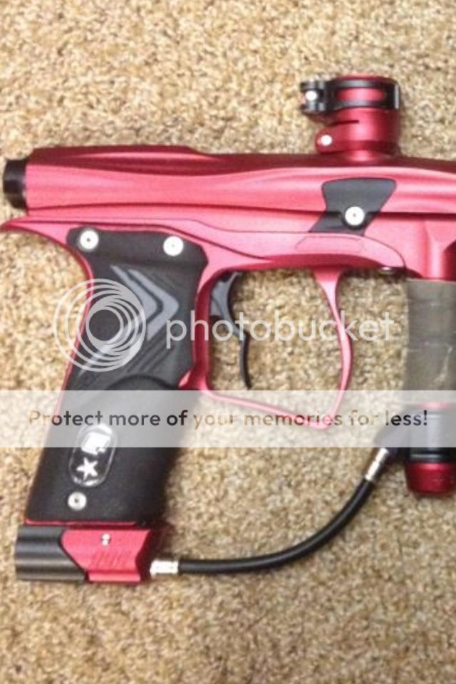

My vicious geo+ 1.2?

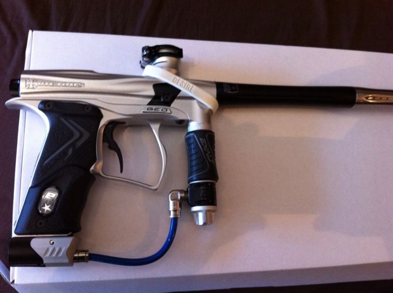

Take it a couple steps further and make one of these

Where did you get that 45 degree collar? And what did you do with the pcv?
