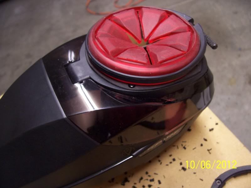

I didnt get any gain from leaving a pod in the feed. I went to just using the large fingers and leaving out the small ones. I would lose a ball or two at the start.
I am a fan of the original crown for the same reasons you posted but the idea was poopoo'd here big time because of appearance, and they said I couldnt do it.
look what I built last night. Exact same size as original top lid and uses stock screws and holes.
baggedbirds is offline   Reply With Quote

I cut a dye quickfeed 6.0 to fit the existing speedfeed ring on my Spire.
The stock speedfeed sucks out loud, the fingers are way too stiff even after putting a pod in it and letting it sit.
You can use the HK rotor version epic speedfeed without modifications, it just fits on there.
Any other rotor version speedfeed and you'll have to remove the tabs on the top ring of the Spire speedfeed to make them work.
