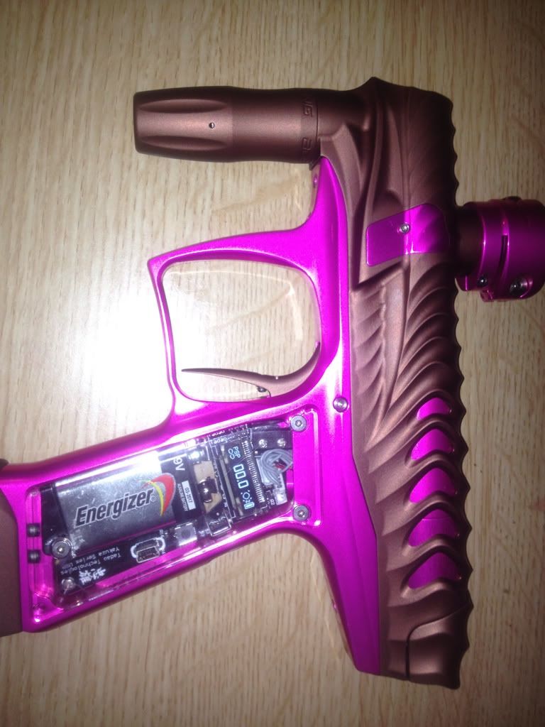

So my victory ripper was fine then took to the field a month later and it shoots 292 290 291 155 289 292 145 and continues this so I took home rebuilt lpr and hpr relubed the whole thing then took out today and it did the same thing the dwells at 6 idk what else to do I know stack tubes but this is my first marq and I'm not sure what I'm doing wrong
I'm also under boring using a freak .679

Not tryign to insult your intelligence but have you tried a fresh battery? just a thought.

Yes I tryed that I think it might have been the old paint I'll find out next weekend.

One time my closer was doing that and it turned out to be a chunk of o-ring in the solenoid.
