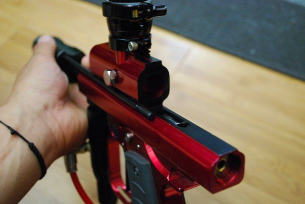

This is the only pick that I have on my photobucket of a double anodize...I know it's not what we're talking about here but it does show that things can be anodized over anodize without damaging the first layer...
It's just a little pocket knife I did for my girl a few years back

Originally Posted by daewootech View Post
kind of looks like he sharpied it? im gonna go in the back and laser some anodized aluminum and see what kind of color effects i can get...
That's not sharpie. It's the dual anodizing that people are currently discussing. Apply this to lasering.
"The family that paintballs together, stays together"
Tonsixer Paintball; Anodizing and Custom Work
Exactly!
