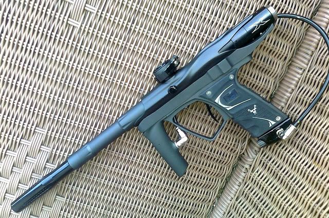

Just thought I'd show you guys my latest shocker that will definitely be a keeper. There's very few of these here in the UK and this one had been passed through around 5 people and was never really completed to a suitable/acceptable standard, thus it just got kept being sold as a 'project'.
specs;
BB milled sft body with DM eyes
Ego 05 frame with virtue re-defined board
rhino sprung HE bolt
delrin sleeve
evolve ulp can
NDZ LP bolt guide
Hybrid VA
Freak barrel
humphrey solenoid with venting block 'mod
vanguard creed asa
all finished in dust black
settings are;
140psi @ dwell of 16 shooting 275 fps +/- 4fps
Special thanks goes out to Renie here in the UK for producing the 2nd eye cover/solenoid vent mod/spring bolt machining and the anodising job. Top work as always mate.

Nice shego! I do recommend a better feedneck.
Trifade Z Intimidator F/S/T

Thank-you.
My rotor fits perfectly snug in the feedneck,I did think about a clamping one before sending it out for anodising but both the rotor and shego are going nowhere fast so all is good.

Clamping feednecks aren't always the best thing. I like the clean lines of the non-clamping varieties....and if the rotor is snug enough not to move, go for it!
Looks great, Eelz.
