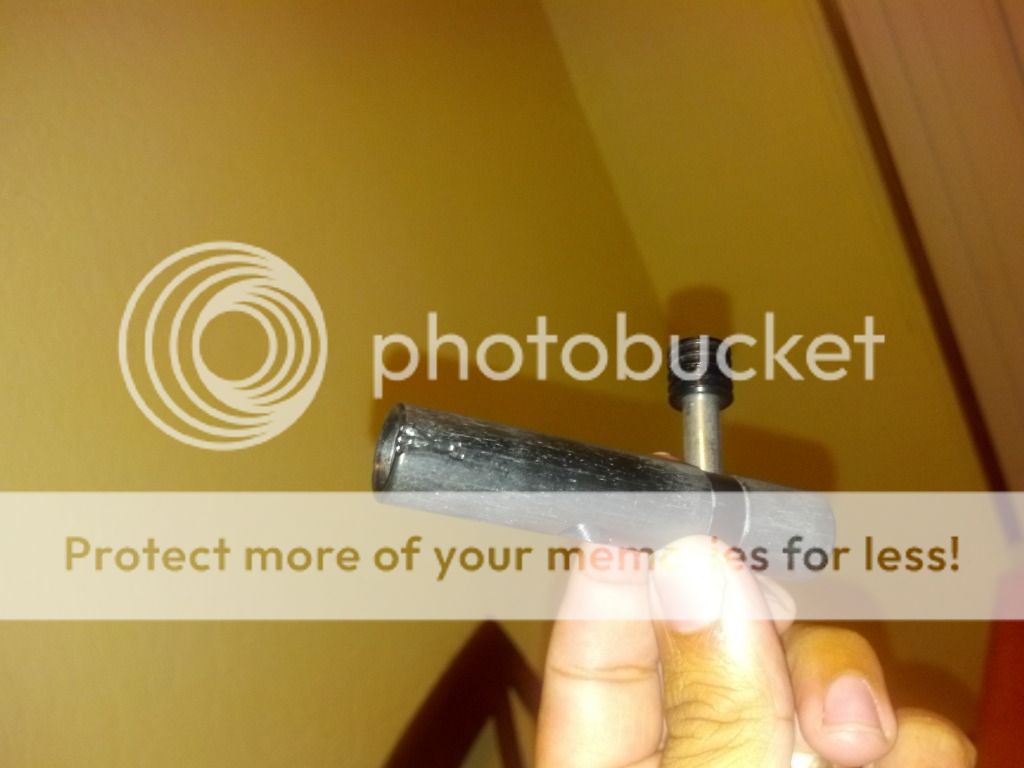

Here are some pics...took them just now and btw the bolt looks 10 times more scratched, pitted, and chewed up in person.
Its really scratched to hell on this side and I believe this bolt was modded to accommodate the detents

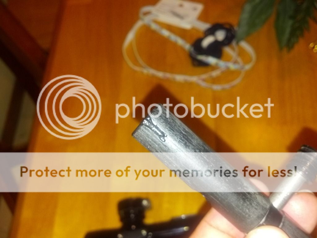

Another shot of the bolt which hits the side of the detents

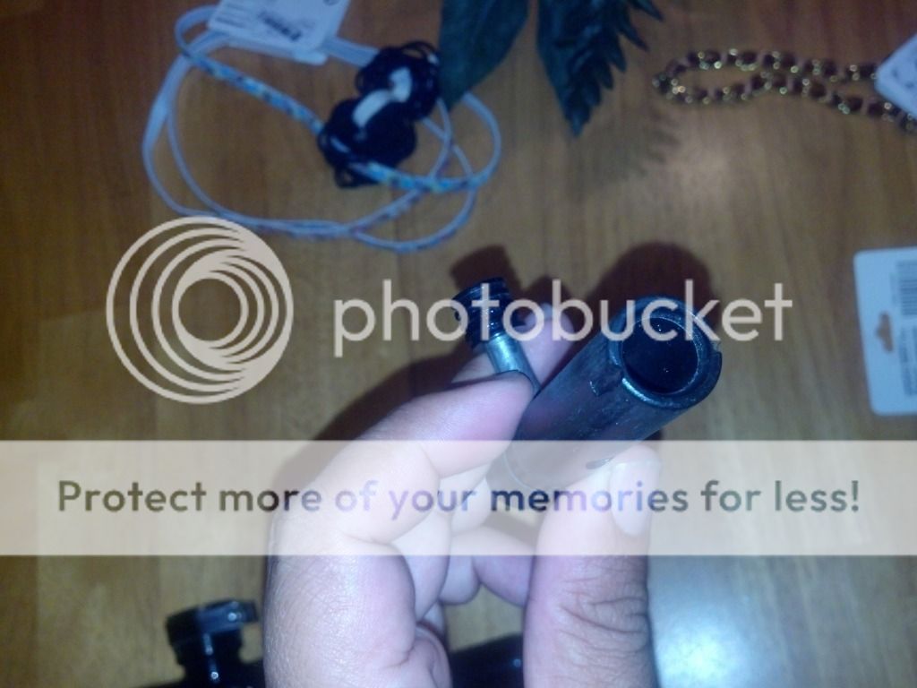

Piece of the right side as your looking at it is ready to come off (tiny piece), but I can just pull it off with tweezers...?

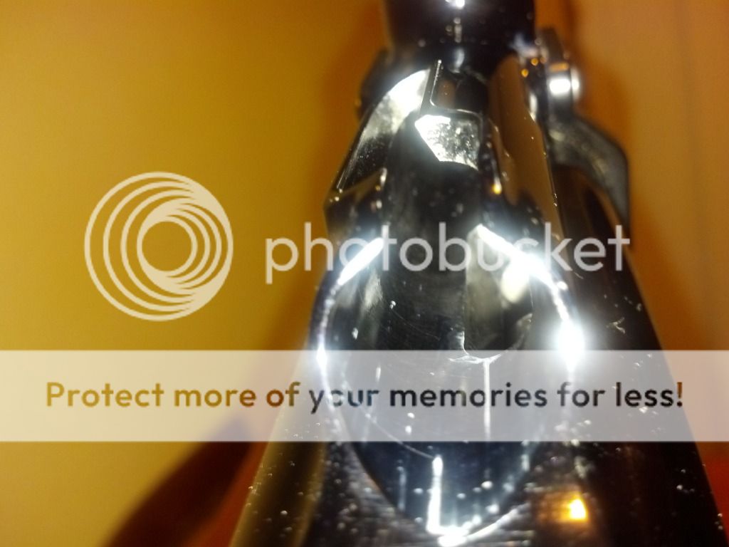

No visible gaps when its in the viking

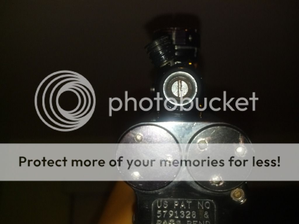

Wear and tear on the back of the tube

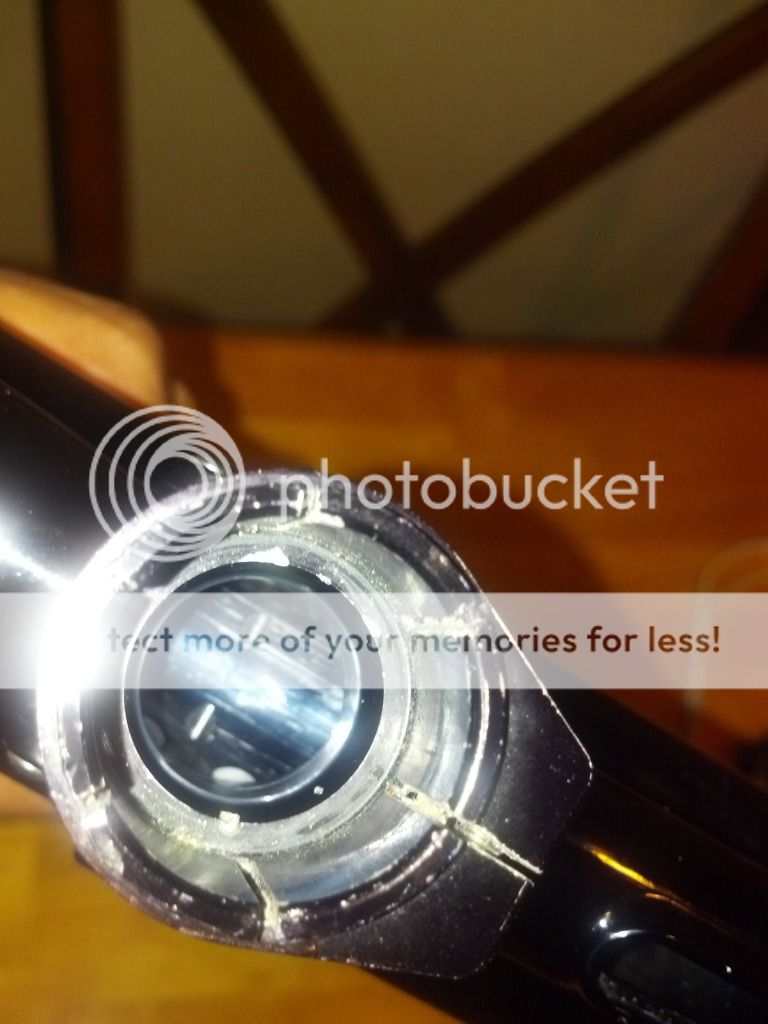

Breech area

I would probably pick up a new bolt for it but the breech should be fine.

Is there any side to side play? Is it ok over the chrono...if those are fine, then the bolt is fine and its pretty much just cosmetic...

As long as there isn't any sand/dirt imbeded in the bolt, your fine. take some 1500 grit sandpaper and some sopy water, and polish/smooth the bolt. When I buy guns that have worn breaches like that I run my honing brush through the breach a few times. Makes everything nice and polished and doesn't take the anno off.

I would just do as Evil said and sand it up and probably clean up the left detent groove.

Actually after further inspection it does wiggle around a bit in the forward position and I can see a gap all the way through now. It was different doing this inspection at night compared doing this during the day. I'm gonna take another picture. Thanks for the replies btw.

That is the sun on the other side...
I'm gonna inquire for a new one...but I have this awesome feeling the viking will still shoot this weekend with this bolt and possibly shoot very well.
