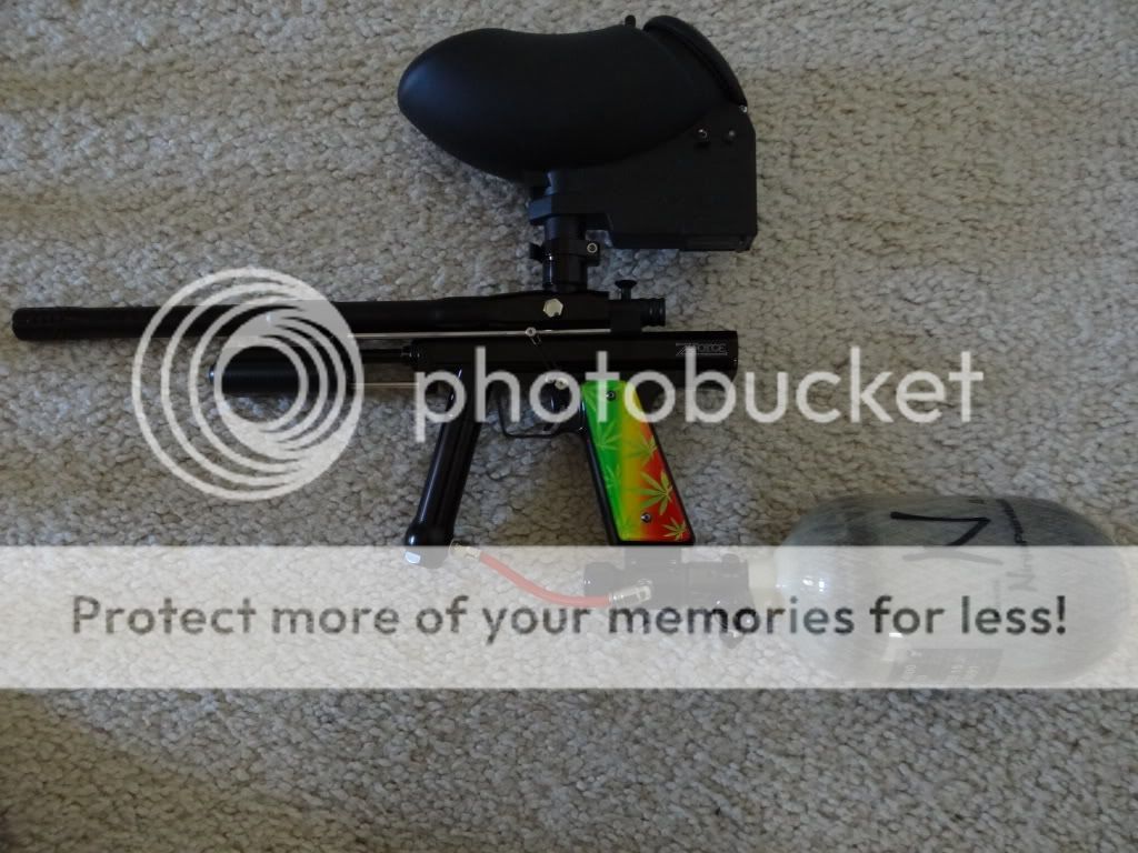

some eye candy for you guys! Thanks for the help!
