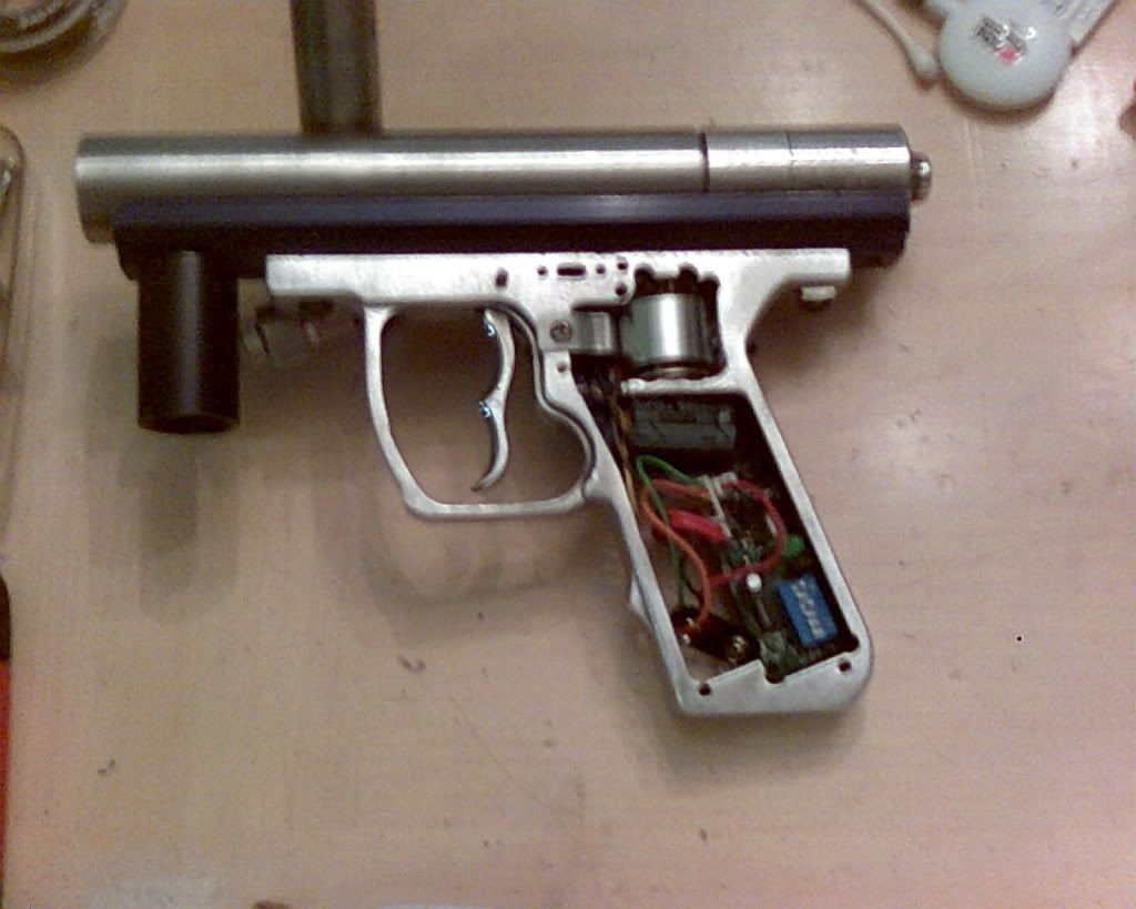

I bought a bunch of Mags for different set ups. I got a Minimag from a friend with no real plans for it. Found an old E99 frame with busted on/off switch from years back. After a drink or two of my favorite liquid beverage, at 2am, I pulled the Dremel out.... I couldn't ask for better results. I didn't cut anything on the Mag, just ground out some of the frame to move the pancake and moved the trigger switch. Had to make a couple connecting rods but after about an hour and a half I had a perfectly functioning marker. It won't "rip", obviously, and isn't any different than a stock Mag as far as functionality. What it did do was extremely lessen the trigger pull distance and force, well worth it considering most of us have an E Spyder frame laying around somewhere and it doesn't cost anything. The E99 board has different settings with burst, auto, etc but the Minimag has all stock parts so it can't handle 13bps.

Jedihippie is playing at Living Legends VI

I pulled it back apart to smooth it out and paint it. Debating on just black or stripping the paint and clearing the aluminum.

Well, still haven't decided on what finish I'm going with. I think I'll polish the aluminum and make a set of aluminum grips for it. Probably do the rail as well.

Originally Posted by inmylife2415 View Post
Electro pneumatic or electro?
Just electro. I'll probably do an electro pneumatic at some point, especially now that I've got that CNC milling machine.
That frame is just a standard E99 frame. You can buy them brand new with all the components for like 10 bucks. I can't really call it an upgrade because the function of the marker is stock but it does make a big difference in achievable ROF since the pull is very short and light compared to stock.
