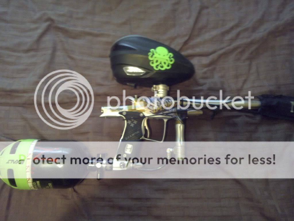

The board is definitely destroyed, and parts keep falling off like one of the jewels, the membrane pad, grip screws, and the screen.
Originally Posted by tonycon View Post
Here is a link for a new frame...saw the close up pics...hopefully the board isn't shot as well.
http://paintballshowcase.com/planete...amesilver.aspx

Old 05-03-2012, 11:52 PM #28
BOOM401
Location: b.c.
BOOM401 owns a Planet Eclipse Ego
BOOM401 has achieved Level 1 in PbNation Pursuit
got her looking all pretty again
BOOM401 is offline   Reply With Quote

Glad to see you got it fixed, what was the process if I might ask? What did you have to pay for?

Originally Posted by skeletar View Post
nice work!
thanks I was really trying lol
in the end i used the stock board which amazingly still works just the screen is smashed to pieces. and bought a ego10 frame which was $90.
