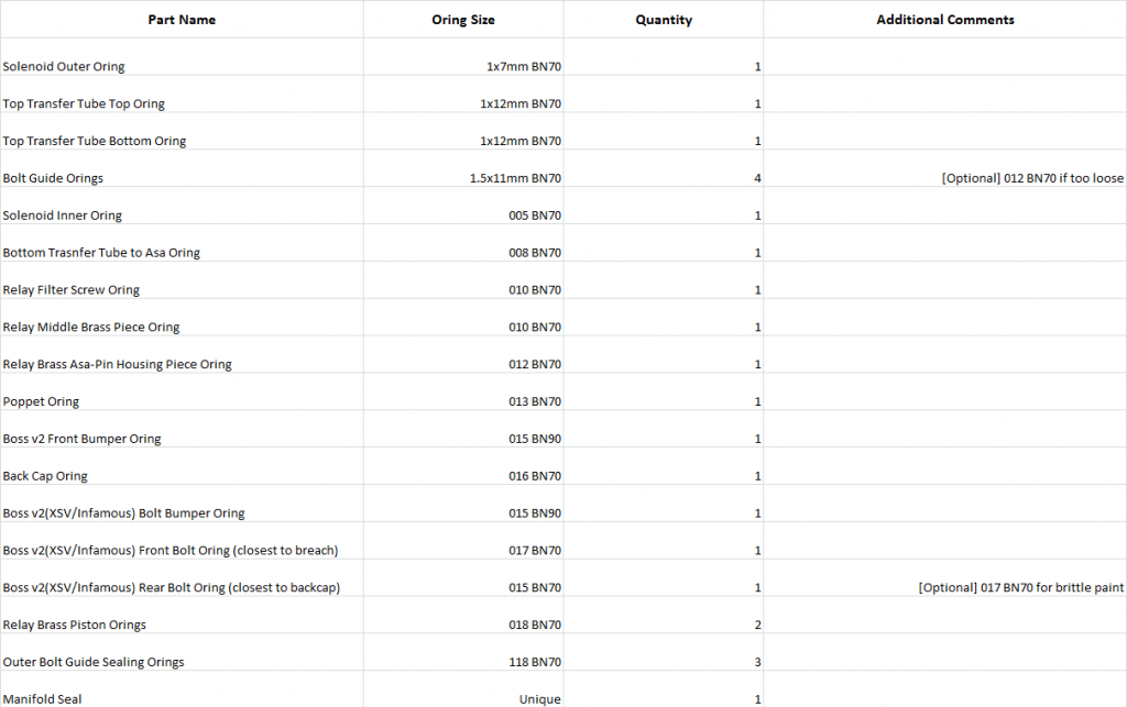

I disassembled my entire axe and made an Oring List for you guys.
Here ya go:

what about the bolt guide o-ring that sits closest to the back of the guide, behind the bolt?

for the stock, thats the 4th front bolt guide oring

shoulda just named it bolt guide orings
its just my rough draft. i can correct the names and stuff if anyone points stuff out
Right. I'm wondering what size it is though?

mine was the same as the front bolt orings - 1.5x11mm BN70
i use the lurker so i have no back bumper oring. but i put the 1.5x11mm BN70 on and installed the stock bolt, and it seemed to fit and work perfectly.
im also not positive of oring boss's new xsv and infamous bolts use as the back bolt guide bumper to shot the fragile paint. the optional oring. if anyone knows, let me know and ill put it on the list for boss v2 axe.

Really? Can anyone confirm that the rear o-ring is the same as the front ones?
Reason I ask, is because I just un-installed my Lurker bolt, and I can't remember what o-ring to put back on the rear of the bolt!

haha, you have the same problem as me then ;-)
also, does the boss bolt use the same rear bolt guide bumper?

Yes all four small bolt guide o-rings (including the bumper) are the same size. I do not change that o-ring for use with any of my bolts.

alright thanks, which oring do you change on your xsv or infamous bolt to shoot more fragile paint with a dwell of 10ms then?

Correct me if I'm wrong, but you replace the o-ring that's closest to the bottom of the bolt with the supplied replacement o-ring. (I just read the instructions )
Correct

bottom of the bolt? do you mean the rear 017 oring on the bolt itself?
