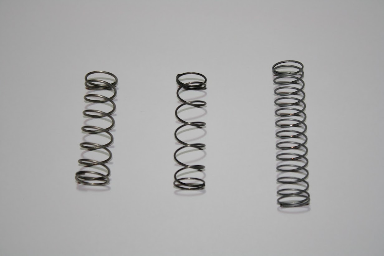

Probably the spring included with the rammer. It is longer and softer but seems to become alot stiffer as it is compressed. The Rhino spring is still probably the best option.
Stock on the left, Rhino in the Middle, Rutley on the Right.
