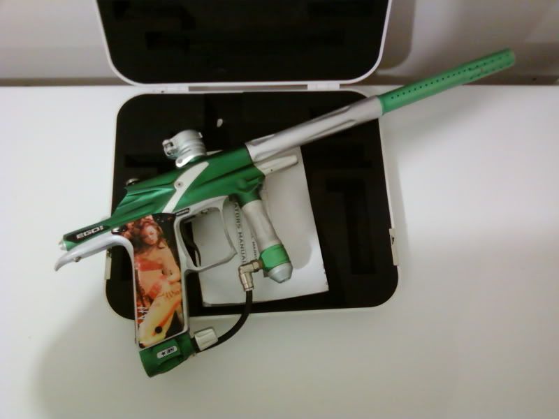

my progress so far. The Easy off worked very well. I actually like the look of the raw aluminum and have thought about leaving it like this. once its polished i believe its going to really pop even more then it does now. I have thought about doing the barrel front but the porting scares me.
before:
now:

look at my pics that i just posted. thats raw aluminum. I think planet eclipse uses a better aluminum which is why i came out so nice.
if you completely submerge the part in the easy off cleaner, it strips the anno evenly. my trigger frame couldnt fit into the container i was using so i just rotated it once and a while. you can tell by looking at it. after a light spray from the can and a little scuffing it evened out.
Dan95-5.0 is offline   Reply With Quote
