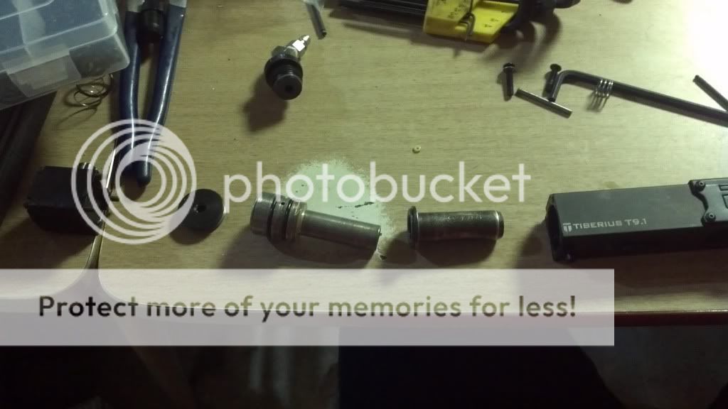

The bolt and back block are completely different between the 9.0 and 9.1. I can take some pics of my 9.1 and post them up along with some info on how it work/the flow of air later tonight when i get home.
dark_controller is offline   Reply With Quote
Old 04-07-2012, 10:34 PM #5
dark_controller
the lower right screw is the air passage from the asa to the gun. the other three hold the adaptor on.
As you can see from the back of the gun, there is no back block like on the .0 guns. the end cap comes off and the bolt and engine assembly push out the back. where as the engine assembly is screwed into the back block of the .0 series markers.
