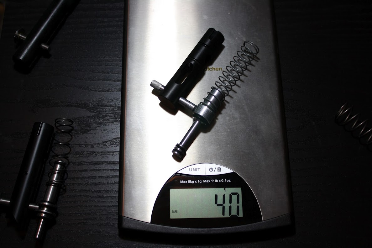

I am going to begin my attempt of a review for Rutley12’s Ram & Bolt combo for the Infinity Legend. I will be adding more to my review further down the road when I get out to the field and get a chance to shoot some paint and can chrono and track pressures with both Ram/Bolt assemblies. Also, throughout my review I will be referring to Rutley12’s Ram & Bolt setup simply as the “Rutley Rammer”. This is not its official name, just what I figured I would start calling it. If, in the future Rutley12 does want a specific name used for his assembly, I will change it in my review.
To Begin, in case you’re not sure what Rutleys Ram & Bolt looks like, here it is compared to the stock setup (with soft face bolt shown).
Rutley Rammer on top / Stock rammer on bottom
Weights – After weighing each part individually as well as all together here were my results.
Rutley Bolt – 19 grams
Soft face Bolt – 35 grams
Stock Bolt – 37 grams
Rutley Ram – 16 grams
Stock V2 Ram – 37 grams
Rutley Spring – 4 grams
Rhino Spring – 2 grams
Stock Spring – 3 grams
Rutley Rammer – 40 grams
Stock assembly w/ Rhino spring – 74 grams
Rutley Rammer w/Rhino spring – 38 grams
Rutley Bolt
Soft Face Bolt
Stock Bolt
Rutley Ram
Stock V2 Ram
Rutley Spring
Rhino Spring
Stock Spring
Rutley Rammer
Stock assembly with Soft face bolt and Rhino Spring (not that is matters but I realize I have the ram backwards in this picture.)
Rutley Rammer with Rhino Spring

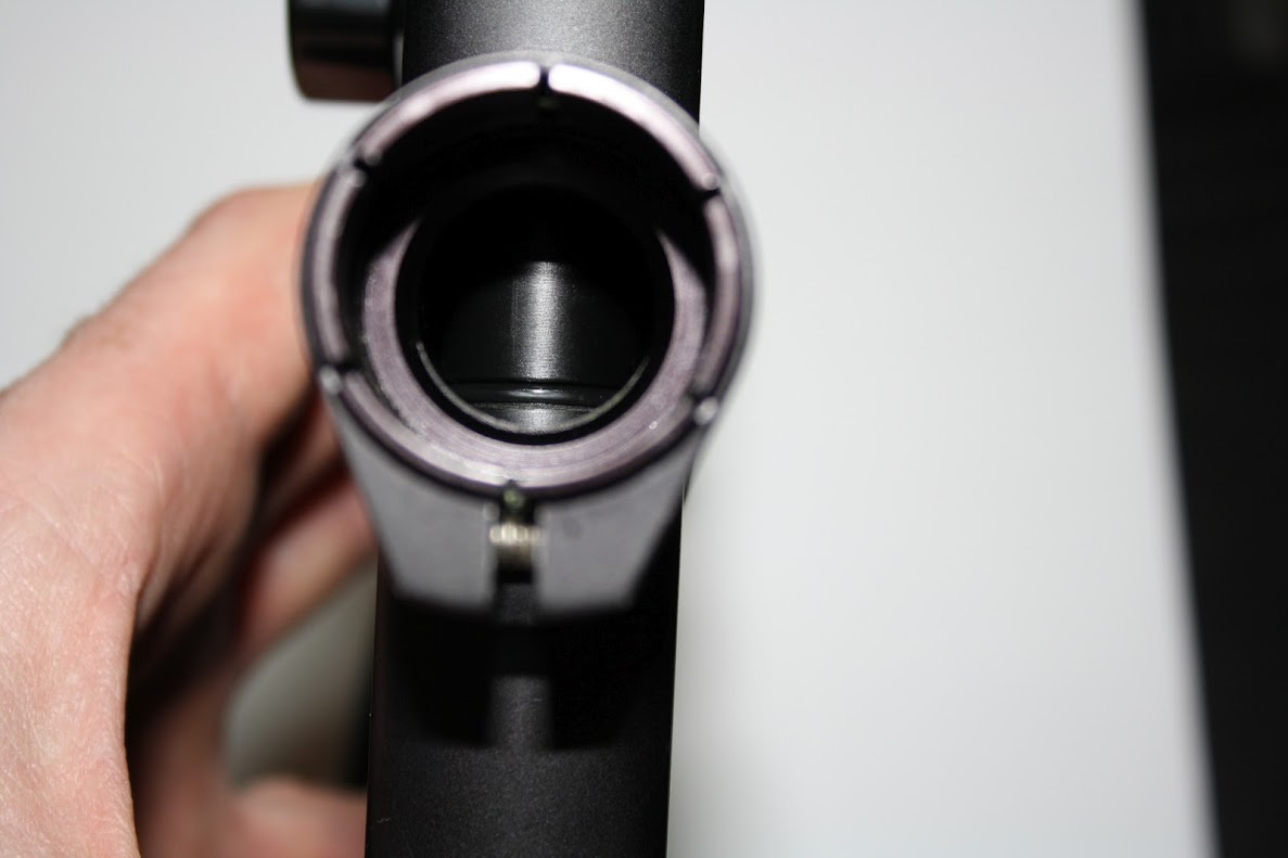

When holding the bolt in the forward position, I noticed the front bolt o-ring top is exposed into view through the feed neck.
I’m guessing this partially defeats some of the purpose of the o-ring and is the reason why Pooty opted not to use a front o-ring when he did his bolt mod. I’m sure the o-ring still helps with making sure that the air is channeled through the bolts air port. If there is any type of blowback, I am not worried as I am either running a Rotor or Vlocity Jr. when running this marker. I will have to monitor the o-ring over time to see if there is additional wear to this o-ring from repeatedly being exposed. *Also I want to note that the air port on the Rutley bolt is larger than the stock bolts, having the larger air port along with the o-rings on the bolt should ensure all the air being directed out the bolt front.
