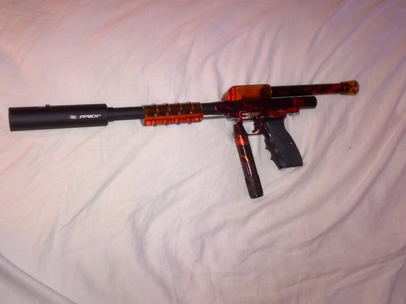

Basically underboring, flutted hammer, and opened face TPC will increase efficiency, but not 50 shots per a 12 gram.
flasc makes threaded phantom barrels, even better is a 678 or 681 bore. heres my phantom with a 678, deluxe apex adaptor, and apex 2 barrel.
