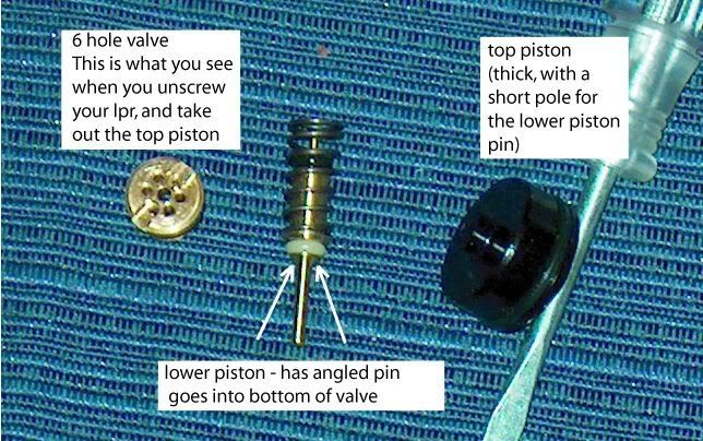

Check if you have SCM1 or SCM3 internals while at it. If you have SCM1 internals, they can be a creeping pain to work with. Here's how to tell which one you have.
SCM1
SCM3
