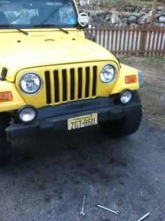

removed my sway bar end links yesterday. They were so rusted and stuck that even after i soaked them in PB Blast the night before, the driver side wouldnt budge. That resulted in having to cut the bolt with my homemade hacksaw
Then I also got a new front bumper from my friends neighbor, he had a stock one sitting around in his yard and gave it to me cause it was taking up room. My old one was rusted pretty terribly, and also had a nice sized dent in it from hitting a tree at around 30mph.
went from this: (best picture i have)
to this:
OT:A - ****ing Scientists.
