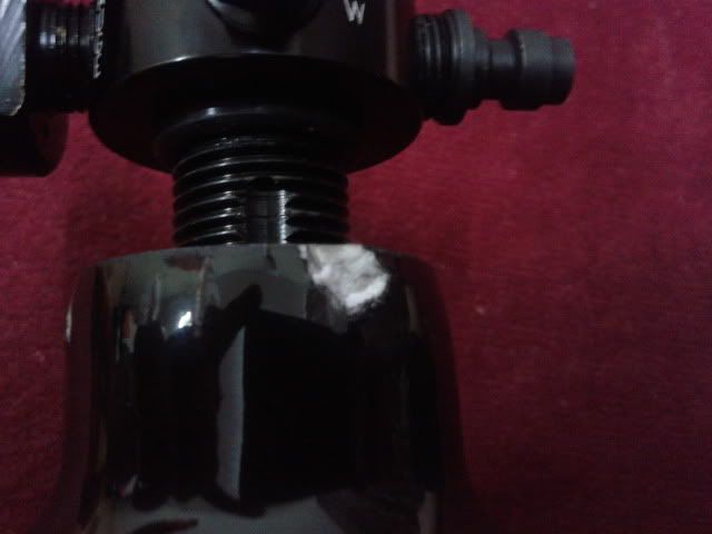

hi guys, i just want to know is this tank is a safe to be used?
I just responded to your email Zulfareez...
