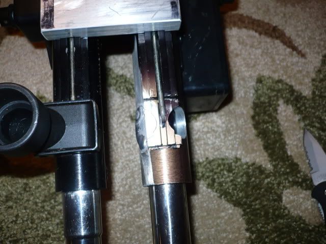

Two tippmann carbines mounted together with aluminum spacer plate. The guns slide into the dovetail on the plate and are held in place by set screws. so the can be taken apart simply by unbolting them One gun and trigger kit were converted to left feed. Gun works fine button under index trigger fires one gun, thumb button on top fires other gun. The they can be fired in any combination of both together or apart. Two psycho ballistics full auto kits run the guns. rate of fire is adjustable on both guns. Both guns also feature stainless Dye boom sticks. you will need to run air lines from guns to asa.
feedneck was plugged and re drilled on the other side. Works great no issues with chopping or cutting balls
joy stick need to be mounted more thoroughly it just slips on right now

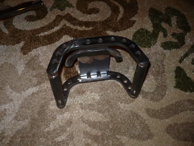

Or you can finish this handle i made up for it.
