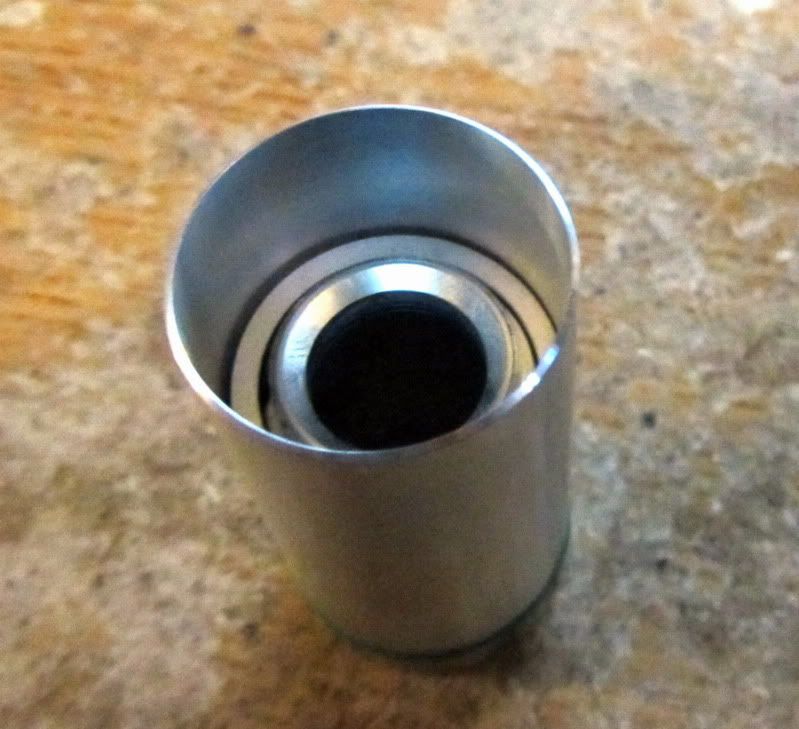

Got mine today..
Am I supposed to lube the O Rings? Or is it best it doesnt move and has just minimal lube?
What size O Rings are these?
Why is there a groove on the ring, but no O ring?
And most importantly.. Due to the lack of install instructions.. DID I DO IT RIGHT??
Before shim installed
Whole assembly
What keeps this whole assembly from moving inside the gun?

Instruction should be the same as the original eigenring except for the sleeve that allows it to be used in the newer dms
I know that you want to lube it up, it works by sliding back and forth.

Ken - You have it installed correctly. Lube the RING only, do not lube the sleeve retention O-ring. Because there is no net force on the sleeve, it should stay in place while the internal volume modulates in response to the pressure change
