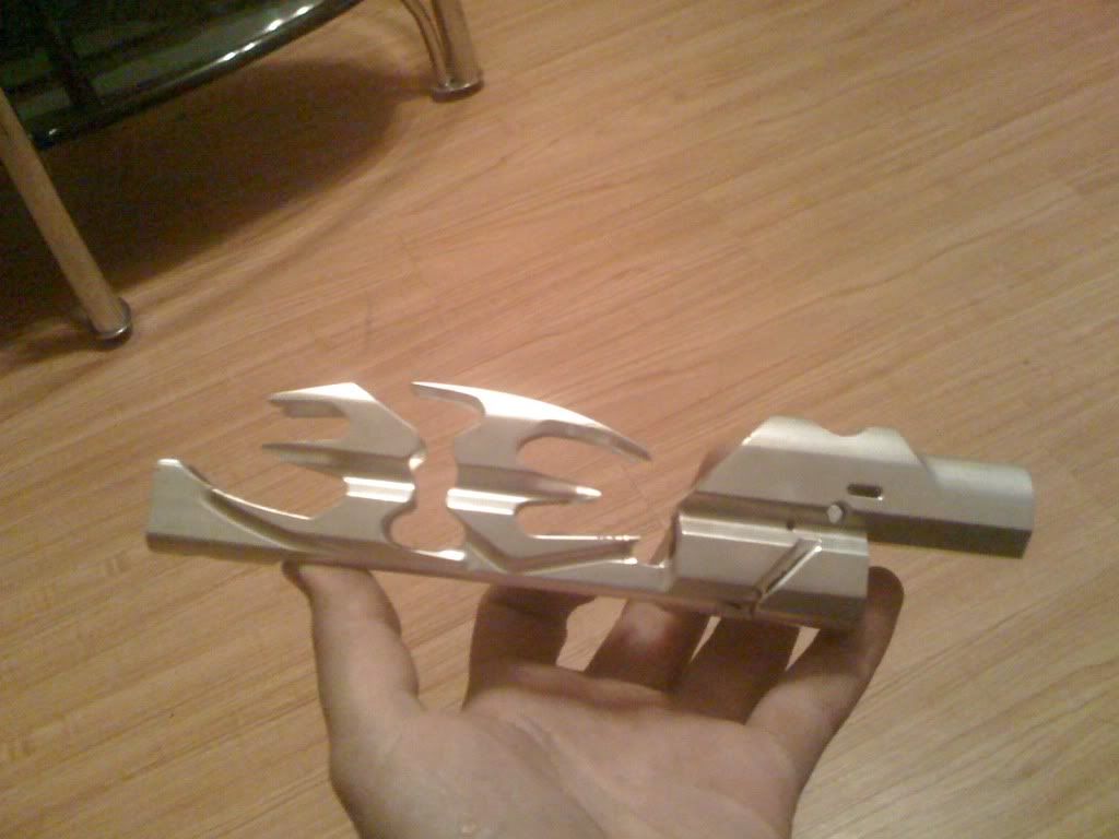

as long as you plan to get them anno'd get them milled too. such as this
thats an old one i did, if i still had it id take better pics, or this one
http://www.intimidatorowners.com/for...ead.php?t=2862
still have that one and use it for special occasions. that was and is my dream build. won 09 gun of the year on iog
