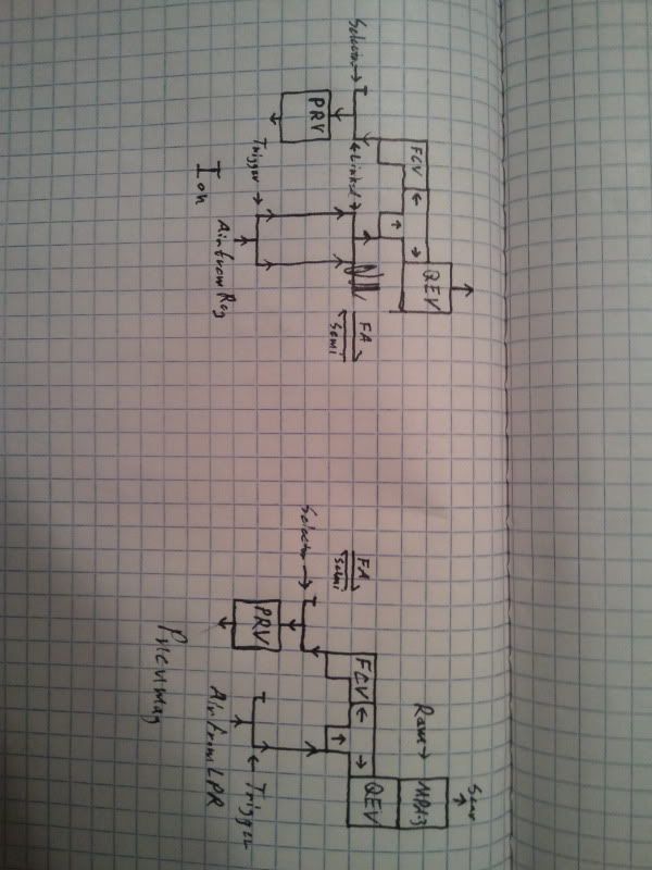

I believe i have come up with a method of making a smart parts ion into a mechanical select-fire marker. To my knowledge, this is an original design. Below is a rough diagram of the circuit. Any concerns/input?
QEV - quick exhaust valve
FCV - flow control valve
PRV - adjustable pressure relief valve

Yeah, sorry i didn't elaborate at first. I posted this as I was leaving for work, so I didn't have time to add details. This circuit controls the flow of air to/from the front of the bolt, whereas the rear of the marker is unaffected. The purpose of this modification is to allow a mechanical full-auto option on the ion and other compatible markers(I came up with the idea when I was toying with the thought of building a pneumag).
The air is directed through a set of three autococker 3-ways, the first of which is operated by the trigger. Which barb the air flows through is determined by the position of the other two 3-ways(which are linked together by a threaded rod). When the linked 3-ways are in the forward position, the air flows just like in a normal ion, firing when the trigger pull shuts off the air flow.
However, when they are in the rearward position, the air begins to flow when the trigger is pulled. As the bolt cocks, the air is allowed to flow past the flow control valve and into the pressure relief valve. Once the pre-determined pressure is reached, the relief valve will begin to vent the pressure. Hopefully, this pressure drop will be enough to cause the qev to vent the air and fire the marker. Once the marker has fired, the cycle should begin again automatically. Cycle rate is controlled by the flow control valve.
Since I have not yet tested it, I do not know whether or not it will actually work as I hope. I am trying to get outside opinions while i gather the parts. Any problems you might foresee?

Ok, i see what you are saying. So are you going to have 2 3 ways side by side connected to the trigger? And where is the other one going?
The only problem I see is like you mentioned, the venting of the flow control valve. I havent had a whole lot of experience with them, but i think when they vent its a very small *puff* of air. This might give you problems if the puff of air isnt big enough to get the bolt completely forward before it starts to recharge again.
Only other thing would be space required for all of this. Very good concept though, its pretty intriguing. You might have to make a try or something to house everything, but heck, a select fire ion could get past a tray lol.

One of the 3-ways will be operated by the trigger, the other two will be operated by whatever switch/lever i decide to use as the selector.
As for space, this isn't going to be on a normal ion frame. I knew it wouldn't fit inside the grip, so it will be more like a bullpup rifle than your typical ion. Only the trigger 3-way will be inside the grip.
In fact, the only SP parts I plan on using so far are detents and the trigger frame. Everything else is warrior, shocktech, or evil. When I am finished, it will probably look more like an automag had a child with a tiberius.

Here is the circuit that should be used on a Pneumag. I apologize for the delay.
You will need a QEV, a tee, flow control valve(unless you want uncontrolled cycling), and a pressure relief valve of some kind. This diagram shows the order in which they should be connected, but you should able to alter the exact layout as long as the order remains the same.
I still have not been able to test this, so it might not work the way i hope it will. If you attempt this before I do, please share your results. In the event that it doesn't work as expected, I'll try to help.
The air should flow through your QEV, through the tee to your sear actuator(I assume you used an MPA-3) and flow control valve, then end up at your pressure relief valve. You must have a QEV or else the pressure might not drop enough to allow for another cycle.
Please excuse my horrible hand writing.

Getting close, but there are a few little things that you'll need to take care of. I think it could work, but it would be a very temperamental system.
QEV/PRV - you need to bleed pressure on the upstream side of the QEV for it to vent, not the discharge side.

In that case, you should be able to put the tee before the QEV and branch from there, correct? This is the first time I've played around with pneumatics(aside from adjusting the timing on my '98 Cocker), so this oversight doesn't surprise me. And I am not too worried about it being temperamental...just wanted to see if I could do it.
inmylife2415,
the QEV allows the air to bleed away from the ram faster, increasing your cycle rate. It opens when there is a ~10% drop in air pressure. Without the QEV, the PRV probably won't bleed off enough pressure to allow the marker to cycle again. Think of the QEV as a pilot-controlled dump valve in this case, with the PRV acting as the pilot.
EDIT: here is an updated pair of diagrams, as per Yoda's suggestion.
