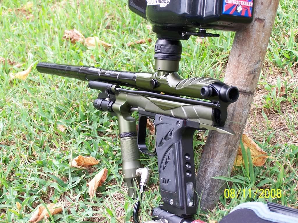

bigger lcd screen on the back. the older e1 screen was smaller and a little offset to the left. its really the board that makes the difference though. it will still work fine, just part of the screen will be covered up.
karnis came stock with the worrblade frame, this one has the larger screen for the e2/zero-b boards:

that was my old gun, i dont regret trading it for my rapper, but i still kinda wish i still had it just cause ive never seen another with quite the same anno on it.
karnivors are definitely one of the best guns ever made.
