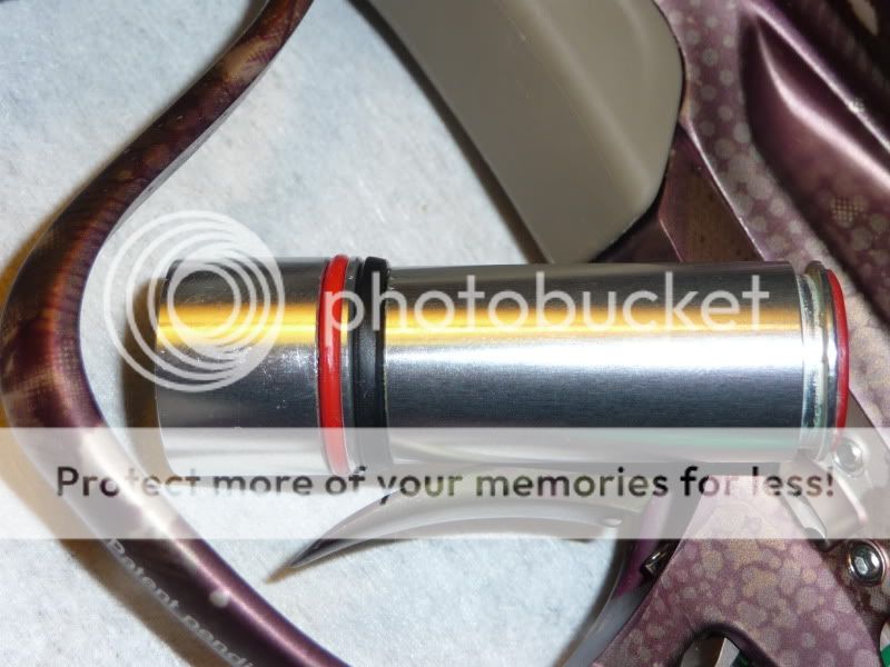

yeah it appears your bumper is a tad large, like Zyzek said its only there to cushion the bolt so reducing its OD a tad with some sandpaper would appear to be beneficial
the circular cuts are clearly from the oring sinking into your inlet holes mid stroke and then being pinched as the bolt retracts

Sanded down a small area, NT shot phe·nom·e·nal today. Green bolt tip, dwell at 10, 110psi, no nicks or cuts or any sort.

Welcome to the sanded down league. = ) Without the seal pressurizing your bumper it's not pressed up against your can. I finally felt I had enough paint through my NT11 to go to the non-factory default green tip insert this weekend, and it shot amazing. I'm glad to see you're having similar results. Did sanding down the bumper lower your operating pressure? it seemed a bit high.

There must be a new o-ring because mine is black and not rounded
Someone on here was saying that. Could you take pictures of it for us please?

Also in the spares box, looks like it could have been sanded down and not molded that shape.
Wow, that's radically different. It's tapered. I guess i need to make a phone call to dye sometime soon.
