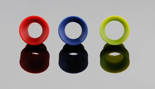

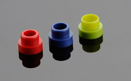

Simplified Airflow And Spacer Kit System
1. Color-coded.
2. Simplified configuration for desired marker performance.
3. 3 bolt tip inserts, red =.275”ID, blue =.300”ID, green =.340”ID.
4. Only 3 spacer inserts, red, green and yellow.
