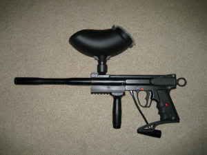

Has anyone just plain cut off the front grip? I mean removed the plastic end piece and cut off the metal part. I had this crazy idea of cutting that piece off and attaching a weaver rail (using a similiar mount method as the stock 98c bottomline).

I've cut 10 or 15 off.
Try to add a body bolt above the cut off area. Two team guns with
body screw added after in pics.
Two different locations for bolt. 1st pic. is better location.

Yup that's what I am talking about. I think it will give the gun a cleaner look with the add on goodies I have planned for it. Thanks for the pics and the tip on the body bolt! Did you just use extra factory bolts?

Yes, drill a small hole right through the gun. Drill the left side only, large enough for a body screw to pass through.
Drill the same hole just a little bit, but with a drill the size of the screw head.
Tap the other shell 10-32.
You'll need to use the right bits to make it clean and the right size to tap.
Make sure you don't hit the ball detent

Not mine, it was a pic I found of one locally awhile back. Sounds like what you wanted to do.

I kind of like that. IMO, the Platinum's should have lost the front grip in favour of a rail like that one WB.

Here's mine, I rounded the whole front end and plugged it up with JB weld, thats another option.
Edit: Note the sloppy nut and bolt running through the front end. I would definitely recommend what The Tinman did, looks much cleaner.

Yup that is what I have in mind. Wonder what brand rail that is?
