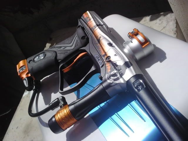

Thank you all for your time , I am really grateful. Fixed the trigger issue just now. It was the middle screw on the trigger. Here's a pic of my GEO and damn proud of owning it!
