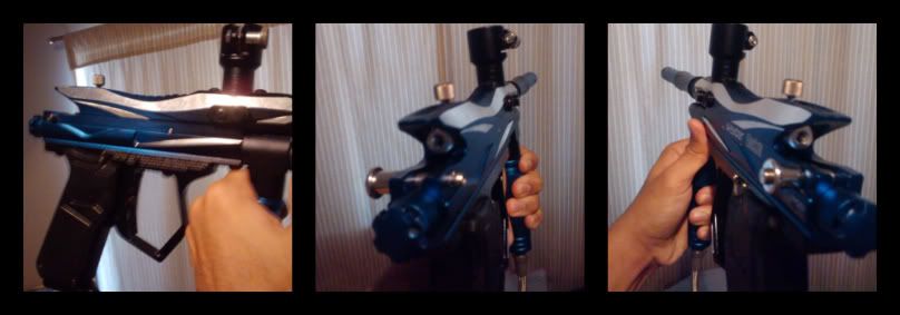

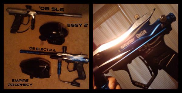

'05 Spyder Electra Acs Upgrade Suggestions
Ok i have a Spyder Electra Acs and am looking for some upgrades i can do to it.
I just ordered a New Virtue Board W/ Eyes for it, a
Spyder threaded Invert Nightstick barrel and
blue dye sticky grips.
Marker before any upgrades, will post after pics when parts come in.
I'm ordering a new Feedneck soon,
but am not sure on which kind.. help?
I was planning on maybe getting a new bolt for it?
if so do you guys have any suggestions on a specific bolt?
Post anything you think might be helpful and if possible a
link on where to find it, thank you in advance.
P.s - No I am not planning on getting rid of the marker for any reason,
it was my very first marker and i want to bring it back from the grave.

feedneck for sure. i say no need for the bolt upgrade. the acs is delrin if i am correct and pretty high flowing. Also switching bolts with spyders can be iffy cuz of tolerances with their markers. Then go low pressure. Drill out your vertical adapter and valve, polish striker and throw a regulator on there. since its a backup and you use your slg mainly i wouldn't put too much money into it. just keep it simple but make it a better than it is with those simple ups.
