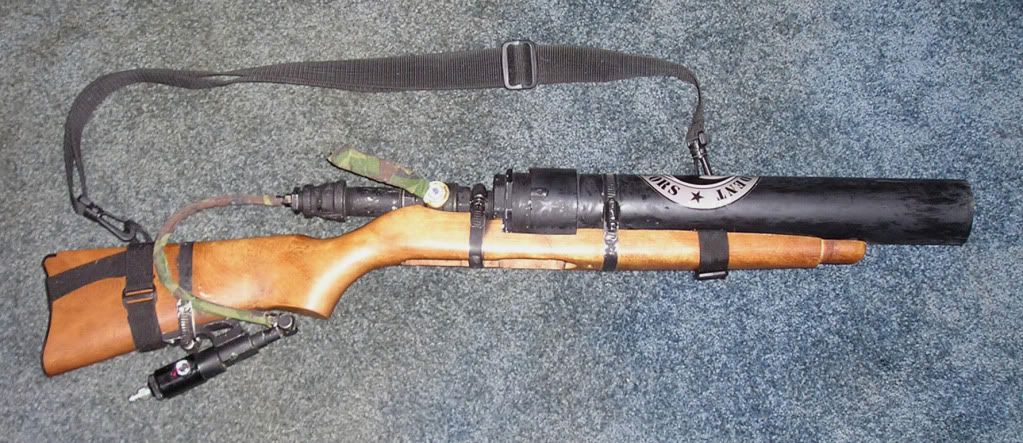

It may be heavier than you're looking for, but it shoots excellent and reloads fast.
duanepc is offline   Reply With Quote

Dang man!! That looks great. Give us some details!!

Based on the size of the air chamber (About 7 ci) I am very curious about the operating pressure that the reg is set at. Supply line from the reg to the air chamber looks like braided stainless steel.

Boom I am with you about the pressure. I have a similar setup with an 8" x 3/4" expansion chamber. I run about 380 psi with mine. Most ball valves are only rated 600 psi.

i got the plans from this site and then adapted to a remote line.
http://www.alternativepaintball.com/m79mkII.htm

So what IS your operating pressure?
Galvanized pipe from the hardware store is rated 300 psi.
Just because you found it on a website and paid money for it doesn't mean it is Underwriters Laboratory listed.
Is that a pressure guage or a regulator with a guage down where the bottle screws in?
