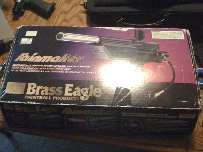

The Box, with a price tag of $429.95

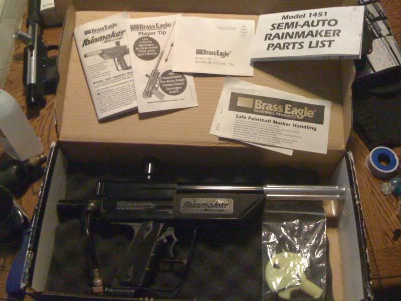

Contents of Box (I had already switched sides for the macroline, Im a lefty)

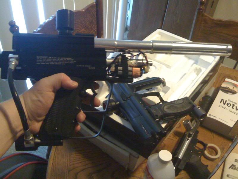

With the shroud off

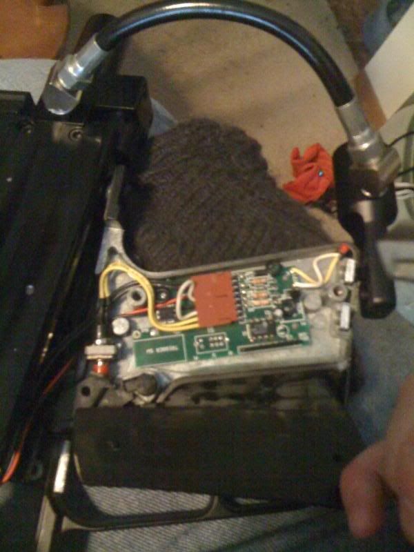

The Board

Your best bet for a new board is a run or custom boards that where made to work with any gun after some programming, to my knowledge, there were never any after market boards designed specifically for the rainmaker.
