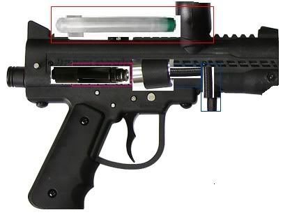

Sorry if its vauge at this point but I just wrote this indetail and then my computer decide to have a problem with the web site and ther it went gone.
OK short version,
1. Remove foregrip and barrel/shorten
2. Move paintball feed level with gun convert to stock class.clip style, or can hopper
3. Move ASA to side of gun, still allow use of tanks/remote coil, would be using 12gram adaptor.
Any suggestions or comments would help, nad yes i know every one this gun sucks and i should buy a real pistol. I would like to get the Tippman TPX but I might as well buy a new gun for that much. I think the only main problem I would have is running the line for the ASA and mounting the ASA it self to the gun.

You have about two inches of barrel maybe. You'll never get it up to velocities on a 12gram with any sort of efficiency and the accuracy will be horrid.
Im sorry but its really not even worth the effort, it would not work at all really.

The internal volume is going to be huge too. most of your 12 gram is going to be used up just filling the areas before the valve.

you may want to look at working a back check into the marker design, right after the changer, so that you dont loose all the pressure you have built up.
This is a problem 2K+ cockers run into, way too much volume. On some an entire 12gram was being used just to pressurize the marker.
Also, you may want to look into some new springs for that marker too. I'd be willing to bet that you will need slightly stiffer springs to make it cycle. But having not worked with that marker a great deal i couldn't say for sure.

well i got the 12 gram into day and actually most of you are wrong, the co2 fills the chamber very well, and I can get around 25-30 shots out of the 12 gram. The only problem I have is that the 12gram will freeze if i start to fire to fast, but this shouldnt be a problem because, If its used as a side arm not that many shots and not that much ammo so i would have to pick my shots. I also could use my remote coil with a tank , freezing problem gone the check valve will not be needed. What I have to look into now is figuring out a way to run some macro line for the gun, then if I can figure that out buy the gun and start doing work to it.

well yes I get about 20 shots at 200 fps little on the slow side but ill take, i might switch over to a 9oz. I dont have the 6 shot tube on right now because I was playing with semi so I the 50 round so I just carry a pod. I left the ASA incase if I wanted to add a tank for weight ballance problems. I now also have the velocity cap and cocking bolt silver.

Uh Well messing around with this idea a little more, I still have to do some paint but did a couple little thing, changed out the internals , working on a custom bolt similiar to the Planet Eclispe Cure Bolt 3. I might scrap that idea, and may keep the ASA were it is just for placemennt of a tank, remote line, ect.

Well I can get vuds up soon, I have all thepainting done, might paint over the warnings, not sure, yet, I currenty have the trigger apart right now. Considering adding (rebound) like response trigger kinda. look for it on youtube.

No it didnt come, that way, I used the internals from an old Viewloader Charger frame.

Well sorta I still have to use it outside and see how that goes, but its been raining for the last 3 days. If you have any questions just ask, and I think there will be some actuall footage of it outside in use, I am still debating if i should get like a Tippman SSL200 loader or something. O the apex barrel is 16 inches to give a size comparision.

I've enjoyed your write up. I think if I was going to use it as a pistol only, I'd install the 12 gram at the fore-grip position and use it that way.
