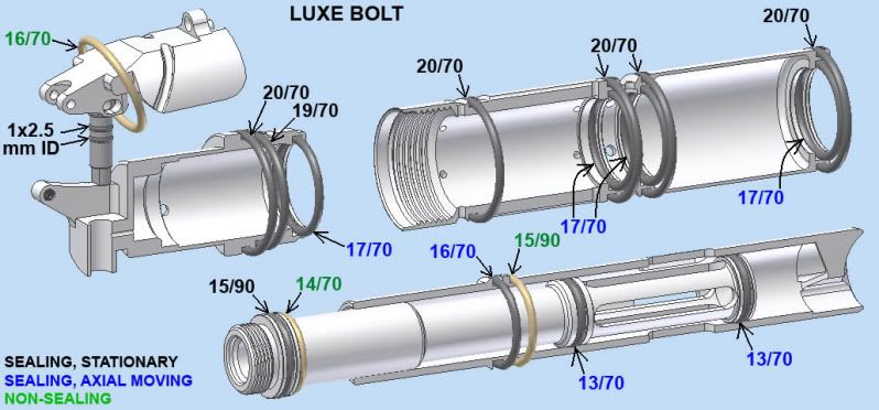

Try changing the middle o-ring in the fire chamber. That is what controls a majority of your efficiency. Also with the Nox bolts, try changing the Buna 16/70 to a urethane.
i already changed the o rings from the firing chamber... u can feel a big diff in the tention sliding the nox bolt back and forth comparing to the stock bolt...and your quote about the buna 16/70 if i only knew what that is..LOL
Where is this middle o-ring in the firing chamber you speak of; and also the 16/70 buna on the nox?
Regards,
Andrew
Inside the fire chamber there are 3 o-rings. the one in the middle is the one you should change. It's a urethane 17/70. And yes the buna 16/70 is the black one on the Nox bolt. There is a bumper and the sail o-ring. the one you want to change is the rear one, the sail o-ring.

This might help:
