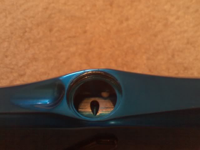

my one quest body (i have two) has scratches on the inside and so does the gm bolt that was used in the gun (see pics).
When I got to air it up the bolt sticks fowards and air gushes out the lpr and breech. Is this caused from the scratches? Or is it something else like the noid?

My gun has scratches like that on the inside. It's fine. A quote straight from Cole "It's the orings that seal, not the metal, so scratches won't affect anything in that area" (paraphrased)

looks like it may be some ugly breech wear it is only on the one side and on the gm bolt. It looks more like scratches then wear to me.

as does mine. that is not your problem.
