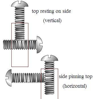

well, im not sure, but i know how i had to lock mine down. try loosening all the screws, top and side. then make sure the reg is fully pushed flush with the bottom of the frame. then screw in the Side frame screws most of the way, then tighten the Top screws inside so they rest on top of the side screws (vertical pressure?). this should pin the reg pretty tightly. (rather than wedging the top screw with the side screw (horiztonal pressure))

nwlzch85
nwlzch85
nwlzch85's Avatar
hope that helps or makes sense. just made that in paint. lol.

Old 04-08-2009, 11:52 AM #6
j0hnny
It did. I thought I had tightened the vertical screws enough but apparently not. It is holding still now. Thank you very much.
