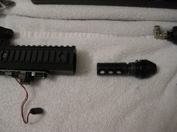

i hav a car stock on my sp1 and i thought i would take some pics of how the stock adapter works cuz i havnt been able to find any anywhere else.

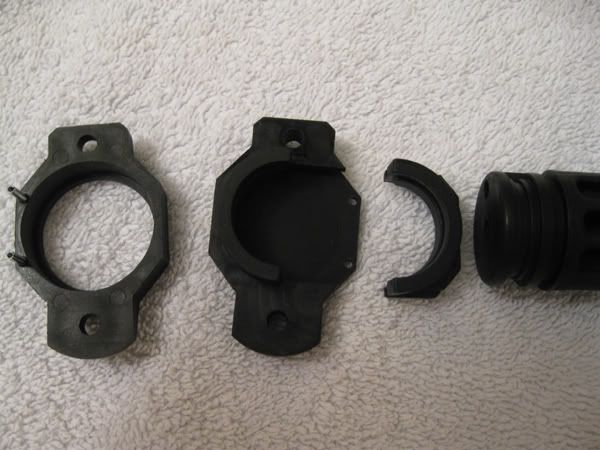

all the parts to the stock adapter and the stock's end
[IMG][/IMG]

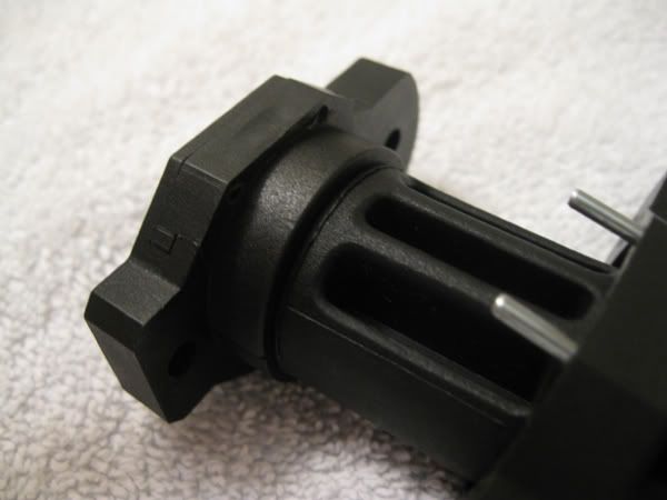

the stock slides into one half of the adapter, you have to make sure the little fin on the stock points up cuz theres a groove in the adapter that the fin goes into and it keeps the stock from spining.
[IMG][/IMG]

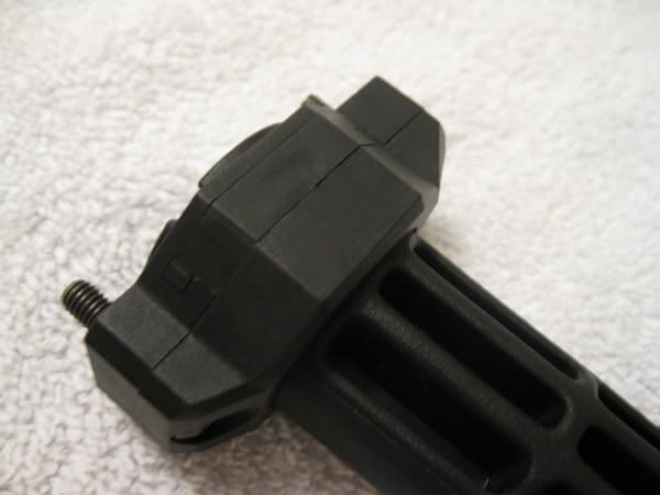

the otherhalf slides into the grooves
[IMG][/IMG]

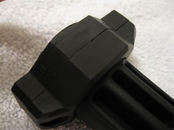

and the cover slides over the two halves of the adapter. those two pins lock the two halves of the adapter together.
[IMG][/IMG]
put the screws in, bolt it on to the gun and yur done!
[IMG][/IMG]
btw the stock adapter takes the place of the back plate.

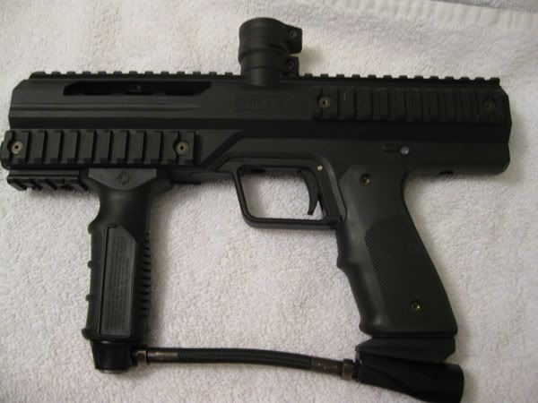

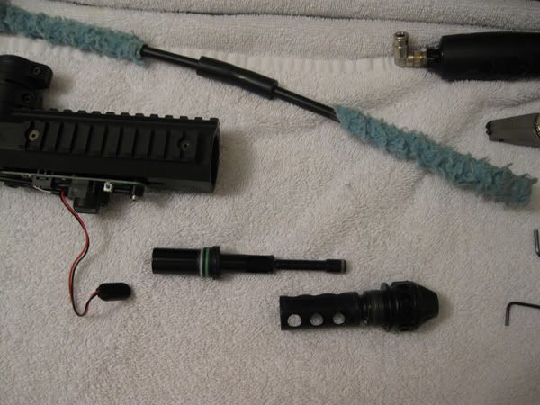

so heres my gun with the stock off and the barrel out ready to dissasemble.
[IMG][/IMG]

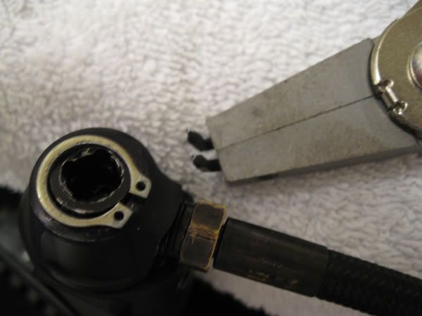

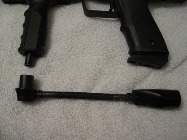

to take the hose off the reg you hav to use a snap ring tool to get the snap ring off.
[IMG][/IMG]

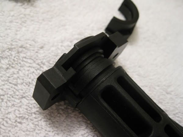

you will prolly hav to loosen the set screw on the back of the foregrip so it can slide off.
[IMG][/IMG]

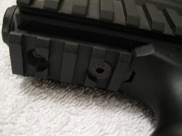

unscrew both of the screw in the bottom rail in front of the foregrip.
[IMG][/IMG]

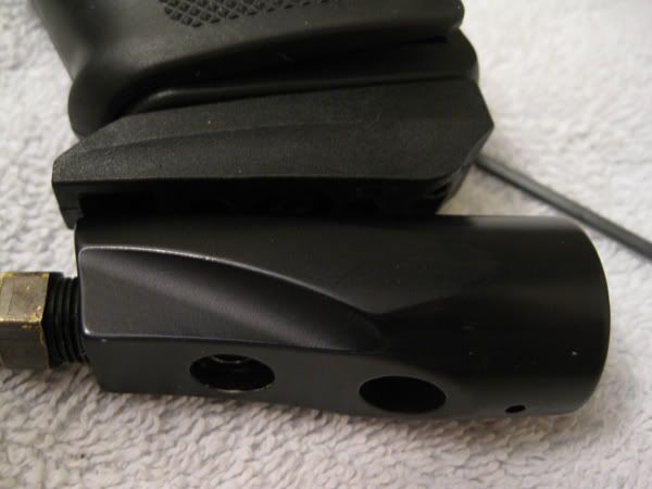

alright so now i hav the bottom line and the foregrip cover off. unscrew the reg from the va. ( mine wouldnt come out so i left it on for a while longer but its easier to just take it off now.
[IMG][/IMG]
[IMG][/IMG]

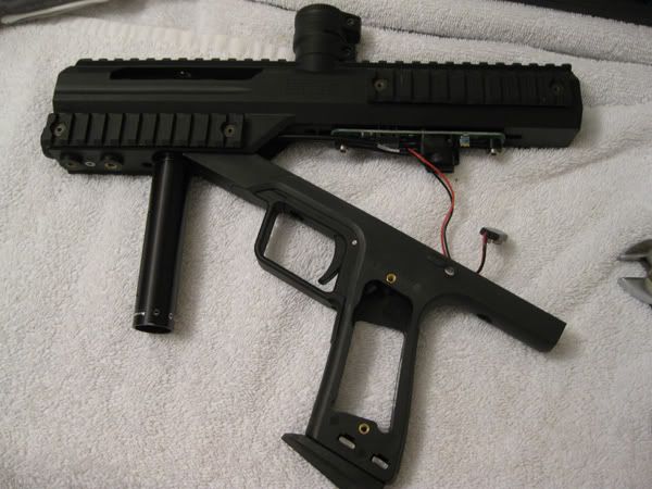

where the red arrows are there are two screw, those hold the frame on.
[IMG][/IMG]
undo them both and pivot the frame out like in the picture, if you pull it strait out the back you might damage the board.
[IMG][/IMG]

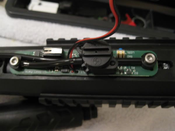

theres yur board.
[IMG][/IMG]

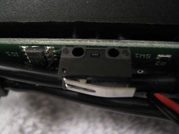

actually theres a really easy mod you can do to make yur gun fire faster, theres a metal tab the covers the trigger switch. it normally is straight but if you bend it like in the pic it shortens the trigger travel and makes the trigger switch ALOT more sensitive
before i did this i could fire like 8-10 bps now i can max the board out very easily (11 bps)
[IMG][/IMG]

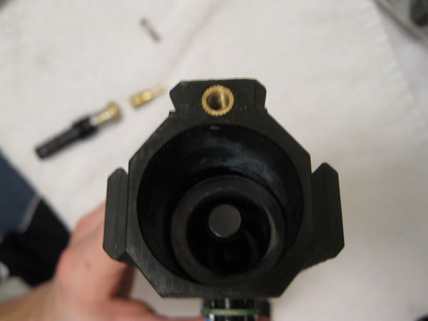

now you can take the tube out. theres two screws that hold it in, one also hold the va (vertical adapter, where the reg screws into) theres a hole in the top of the gun where the barrel goes, if you look into that hole you can see a screw, take that screw out.
[IMG][/IMG]
