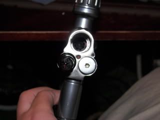

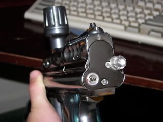

Step 1:
Remove the front seal, back plate and grips.
Front Seal: (right tube allon thing)
Back Plate:
