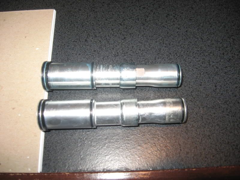

OK, i baught 2 2008 SLG's from 2 different members on the forum. But they both came to me with short bolts and the roll back issue. No problem easy fix b/c all you gotta do is mail your bolt to dye and they replace it. I keep one and sent the other. in this pictures the top bolt is the New proper sized bolt, and the bottom one is short.
(both bolts still have lube on them thats y they dont look smooth)
Now they look almost i dentical in size, I dont have a a proper measuring tool other then a ruler and from the ruler they are the same length. Now what proto did was just replace the tip of the bolt, the back half was my original bolt it came back with my originial scuff marks lol. The new tip has slits in the side to use a wrench on.

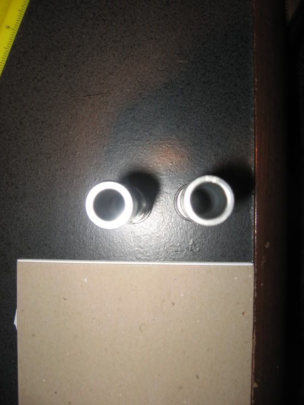

The difference in length comes into play at the very tip of the bolt (thicker wall)
as you can see the top bolt (new bolt) has a thicker wall which makes a lower contact on the ball onces its in the chamber and pushs the ball further forward and breaks the eye beam. So the old bolt isnt short, its not a matter of length its a matter of where they touch the paintballs.

I believe they just used the 09 slg bolt tip as it will fit on the 08 slg.
the "updated" bolts for the 08 slg were the black plastic, and were later changed back into metal bolts after the first run of 09 slg's snapping due to the thinner wall where it threads to the back of the bolt.
, kinda different than the whole short bolt issue. but you right, the larger cup area will keep the ball from rolling back into the bolt as much.
