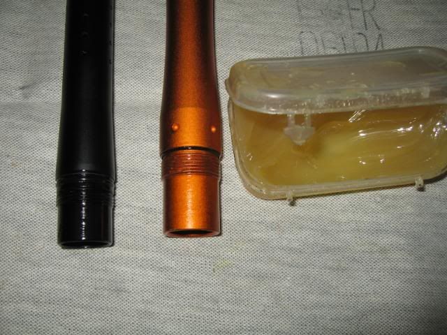

While there are so many lubes out on the market today, DP recommends the use of Dow-55 lube on the entire marker. I agree with this and you will notice that even though I have Dow-33 in the Picture of the workplace. I don’t use dow33 on this marker except on the internal solenoid piston, which is my preference. Any type of lube will work, however to avoid leaks and extend life of O-rings, the use of a swelling type lube is the recommended.

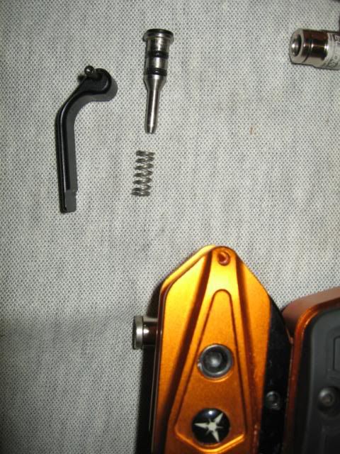

Step #1 Pull the bolt pin up and slide the bolt out the back.
Step #2 Turn the ram cap ľ turn counterclockwise and pull out the ram assembly.

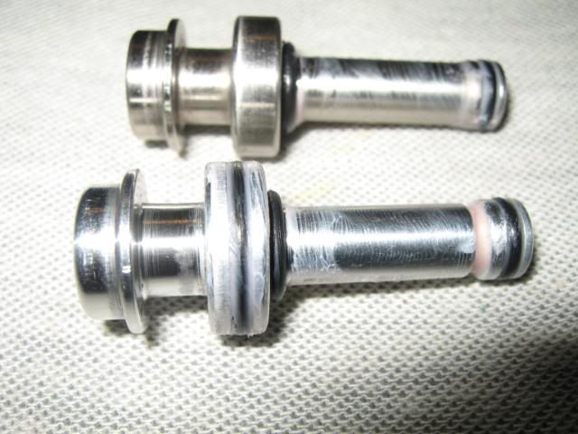

I have the Eigenram (extra O-ring)and the stock ram pictured below.
Step #3 Clean all lube off the ram, and then reapply new lube to the ram's sleeve (black with 2 O-rings) and the tail section of the ram. Basically, just apply lube to all O-rings.
Put everything back together in the same order you took it out.
Remember just a ľ turn to lock the ram in place.
If your ram cap is loose you may need to tighten the set screw for the ball bearing that secures your ram to the body. If the screw does come loose, it would be a good idea to apply blue loctite to the threads before replacing to ensure it doesn't happen again.
Here is what the retaining bearing assembly looks like.
If you install an Eiganram you may need to sand your stock pin to fit into the ram. You will only have to sand a very small spot on the bottom of your ram. Look at the picture. The black spot indicates where you need to sand. You will only need to take off a very small amount of material. I would suggest that you sand it flat and check the fit often by inserting the pin in the ram. Notice that the black mark is directly below the slot.

Step #6 Clean all lube off the outside of the LPR. I have some cheap tank O-rings on there now, that's why some are orange.
Relube with Dow 55
Put a small amount of lube on the valve pin O-ring and spherical part that contacts the valve, before putting it back together.

Step#3 This is the internals of the RAPS. The piston, with the 2 O-rings on it, need to be lubed with dow55 or similar swelling lube.
These 2 O-rings are the cause of most leaks associated with the RAPS. Usually you just have to lube the O-rings, but if they show any signs of wear, replace them. Lube them with any lube you have on hand, swelling lubes work better. If you lube with Dow55 and you get a leak, it’s most likely because the lube has worn off and you may just need to relube them.

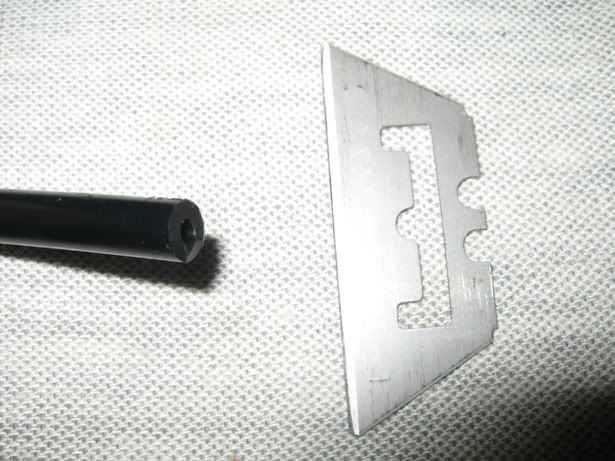

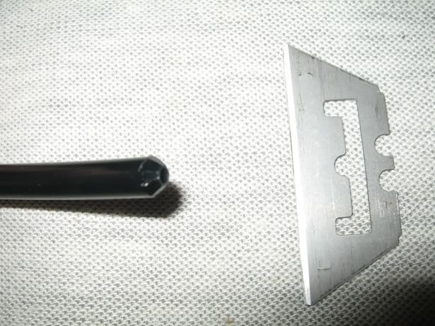

*Here’s something to save you some grief with putting you’re micro lines into the elbows.
Taper/round the end of the macro fitting slightly. In the picture I just cut it with a razor blade. It makes inserting the macro much easier and holds just as well as leaving it at a 90* angle.

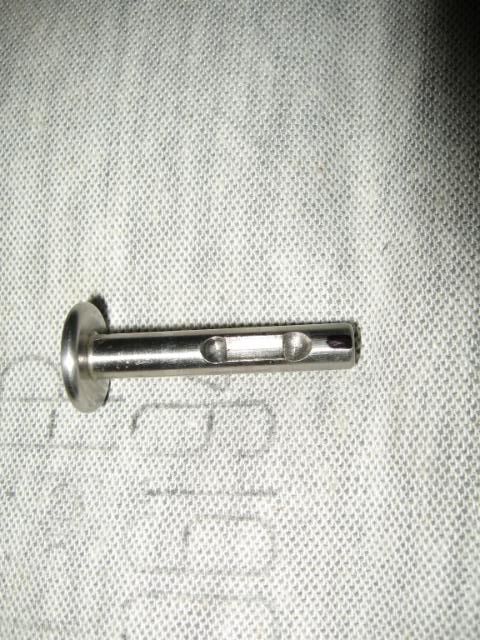

Step #1 First, unscrew the 2 mounting screws securing the solenoid to the body. These screws have very small threads and, if over tightened, can strip very easily.
Step #2 Remove the 2 O-rings that seal the solenoid to the body and place them in a bag or safe place. These are small and can be lost very easily.
Step#3 Time to use that screwdriver. The screw driver Iím using is a 5/32 flat head screw driver. You can use another size screw driver just as long as it fits the screwís width. If you use too small of a screw driver; the screw will be harder to unscrew, can damage the screw head, and possibly strip the screwís head. This screw can be very tight and being on such a small object, can be difficult to loosen just by holding the solenoid. If you canít unscrew it by holding it, you can use a vice. Be sure to put something on the sides of the solenoid as to not damage it. You can also use vice grips, but as before, protect the solenoid from any metal device holding it! Leather is great to use.
*Warning* Do not unscrew any other screws other than the screw above. If you damage the sticker on the side DP wonít warranty the solenoid and you will have to buy another one if your solenoid canít be fixed
Step #4 Welcome to the most frustrating part of the solenoid. Depending on the condition of the O-rings, lube, and piston, this can be a pain in theÖ If youíre lucky enough to have a pair of small tweezers that will allow you to just grab the piston, while fully inserted, your luckier than I am and can skip the next paragraph.
Hereís the dance and be prepared to put your patience to the test. Find a hard flat surface that will not shake or move. Place a few sheets of paper or something similar that will remain flat, but wonít harm the finish of the solenoid. Like the HPRís piston, you will need to turn it upside down. Holding it securely and at a perfect 90* angle to the flat surface; sharply hit it against the surface. You may need to do it several times, but what you want is to get the piston to move towards the screw opening. Once it's moved forward grab it with pliers or tweezers.
Step #5 This is what you should have.
Step #6 Clean it up, replace O-rings that are showing ANY wear, and relube. You will only need a thin layer of lube on these O-ring. Donít over lube them and stay away from any swelling lubes.
To put back together, just reverse steps. You donít need the solenoid piston screw anywhere near as tight as they have from the factory. Just tighten it up, but donít crank down on it.
Also remember those 2 little O-rings that you placed in the bag. LIGHTLY lube them with Dow55 or other swelling lube and donít over tighten the screws that secure the solenoid to the body. Once you feel resistance, tighten each one just a little bit at a time, alternating from one to the other until tight.

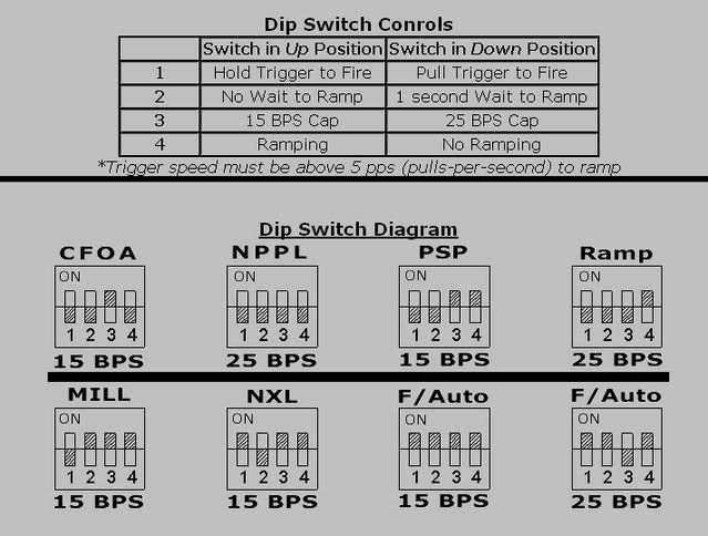

Here are the Pictures of the Modes for the Fusion V2 board. If you have the V1 board DP allows you to upgrade to the V2 board for a very small price. The F8ís modes are identical with the exception of the full auto modes. The last 2 modes that give full auto on the Fusion are ramping modes on the F8. Full auto 15bps is ramping to 15bps 3bps activation. Full auto 25bps is ramping 25bps 3bps activationon the F8.
I posted this one just incase people want to save the image to put inside there markers grip.

The last thing I will mention is just a trick that Iíve been doing for sometime.
I like to lube my barrel threads on all my barrels with a thick lube. I use Slickhoney since it lasts a long time. This is just to keep the threads looking new and prevent the threads from binding and becoming damaged. I do this with my ASA threads also.
